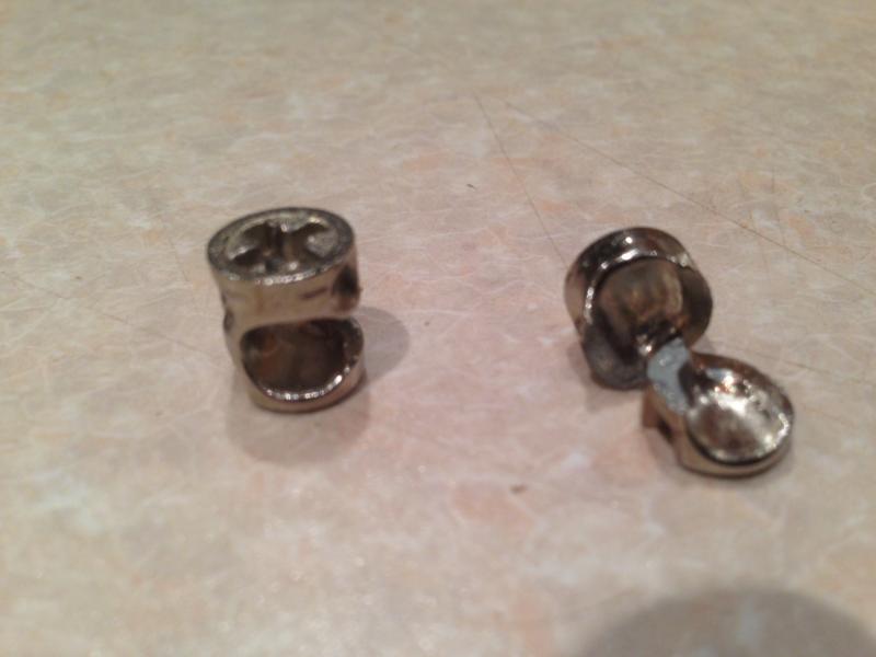

Recently two of my kitchen drawer front fixing components have broken. Two of the screws that grip the lug on the drawer front have sheared off.
I have no records of who the kitchen is made by. The only thing I can find is the worktops are by Durapol.
I've looked all over the web & done a google image search as well and not found anything yet.

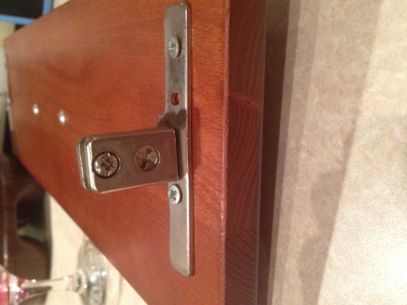

I've attached pics of the bracket in place on a drawer front, and a whole & broken "grub" screw (don't know proper name for it).
Also attached pic of bracket on drawer front with the lug.
Does anyone know where I can get replacements from at all?
Any help would be great as this is rented & we're moving out in a couple of weeks!
Nick
They are known as minifix cams, and come in varying sizes.
Your options are to source replacements, I would take one with you to iron mongers or DIY store/shop/shed and see if you can match up.
Or buy a new draw pack.
If the draw sides are timber just use L brackets, more secure than existing.
