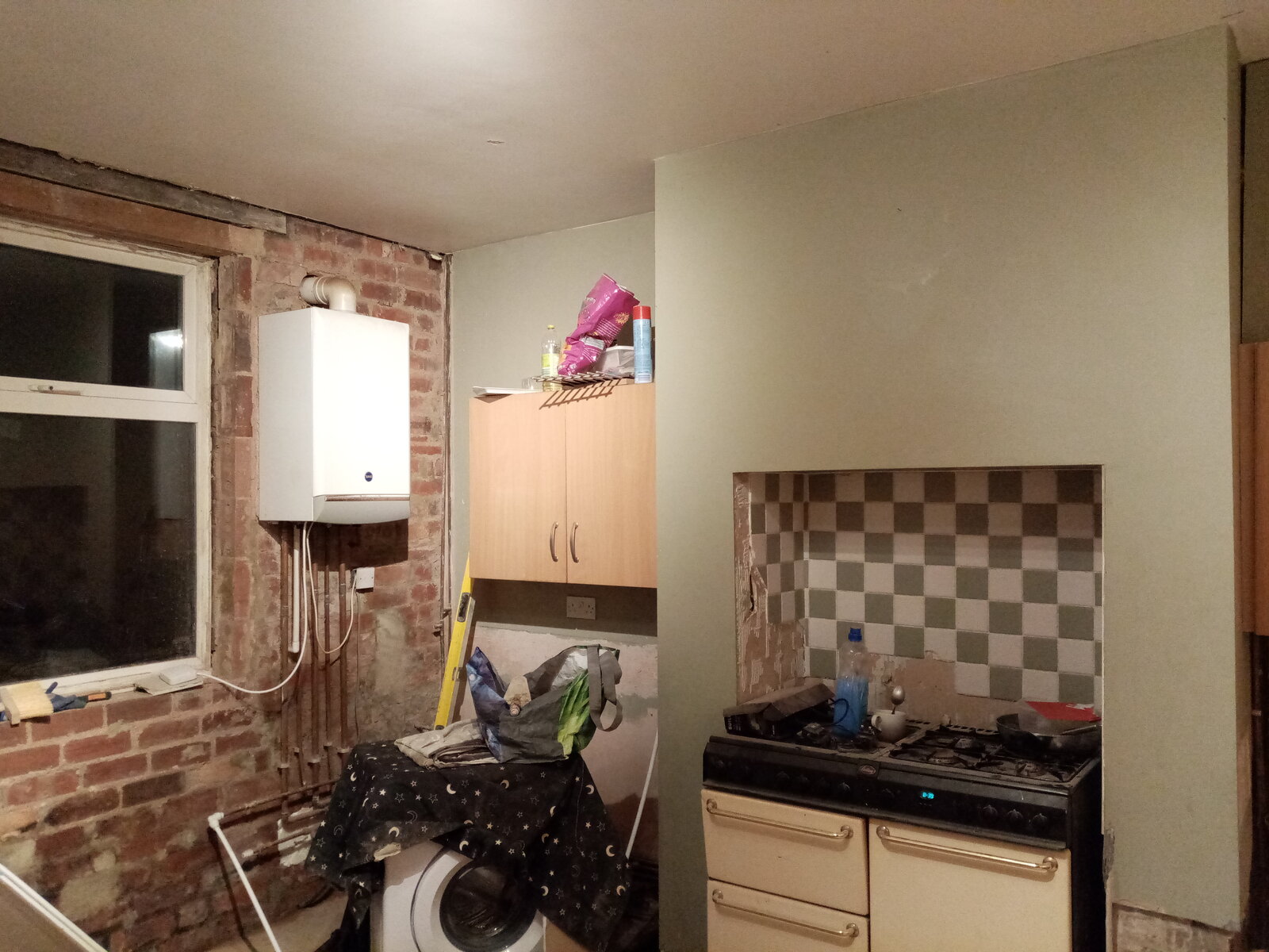

Just renovating my kitchen, currently it has no extractor fan
Hob will be in chimney breast
Going through chimney would be costly, and running a extractor flue/pipe above units and out room will loo awful
Do i need an extractor or will open window do the job?
i want to minimise condensation
do all extractors need external ducting?

I would install an extractor which vents outside, Why? because in Autumn + Winter it will be very unlikely that a window will be opened? far too cold !! and the re circulation type of hood will add hugely to the "free water" which has to condense somewhere?
As for how to route an extract duct? is the chimney breast on an external wall?? if so lead the duct into the bottom of the flue and vent to the outside, do not run the duct all the way up the flue to the chimney. ??

No, it is on a party wall. As i look at the chimney breast, the external wall is to the left. I'll grab a picture ...
Would you put it over the wall units? Would this look awful?

If you use [say] the plastic rectangular duct, and keep it as close to the wall as possible, it "may" be difficult to see it from the room??

thanks again, i've just looked at them and they seem pretty neat. Having never installed one before, how would i go about installing it?
How do i connect the ducting to the extractor, and what size / shape hole do i drill in external wall?
Edit: Would an alternative be to have a standard 4" vent that is typically used in bathroom? I could install it to the right of the boiler so won't be seen easilly?
Would make it easier for me to install?

yes, put it on top of the wall units (or inside, if you have 900mm cabs and a 2400 ceiling) or box it in above them, close to the ceiling, with matching top-boxes or dummy doors, which you will need if you have a 3000mm ceiling, as cabinets are impractical, and spaces get very dirty. If you use cabinet hanging rail it is quite easy.
round rigid duct is easier to clean, and easier to core-drill the hole
modern extractors are usually 125mm or 150mm
