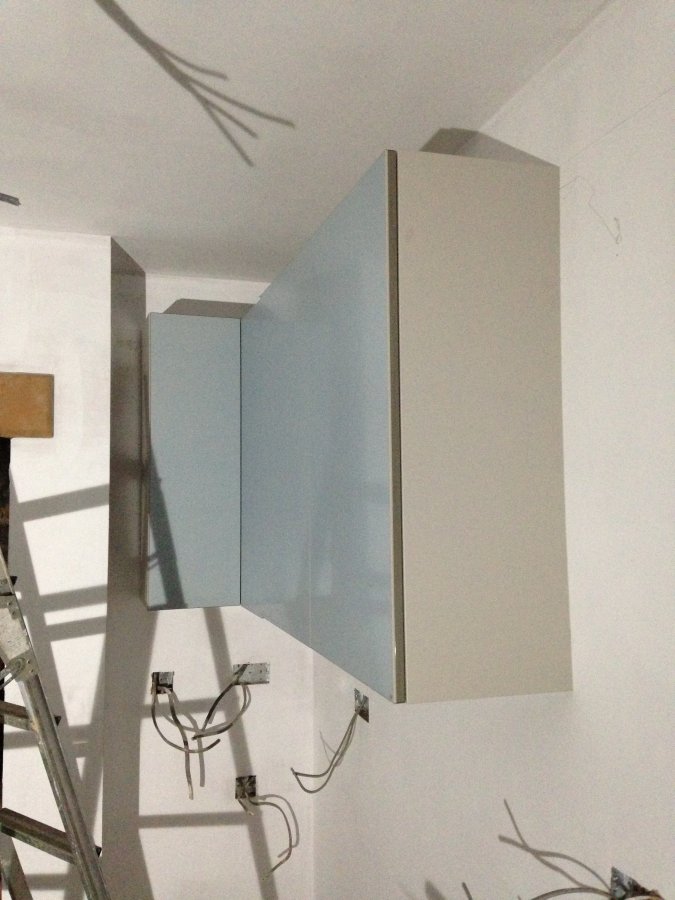

This is as far as we got before we had to go and pick the kids up:
I'm not sure how she will reach the baked beans from the top shelf ;)
They look as though they're set a bit high for anyone. What's the height of the lowest point of the cupboards.
Just worked it out; you could have come down 50mm, possibly100, but she'll still need a step.

Here's the jigsaw:
Under the circumstances, I can see the reason for starting on the wall units. Make sure you keep all your mdf doors and panels flat on the floor, as they'll bend if you lean them against anything.
