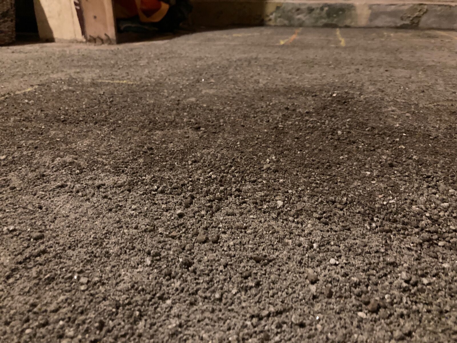

I am somewhat out of my depth with a house renovation and would massively appreciate some advice regarding the kitchen floor...
There has been subsidence at some point in the house and the concrete kitchen floor was uneven to the tune of around 50mm from high end to low end. I ripped off the tiles and after finding some weak spots in the concrete and pockets of hollow space underneath, for better or worse I dropped the whole concrete floor with an SDS drill.
On my father in law's advice, we removed a good deal of the hardcore and laid sand screed over the top of remaining hardcore to get a level. He assured me that we could put in a DPM after the fact and now he has returned home leaving me with a set sand screed floor (a good deal of loose screed on top), no DPM, no concrete subfloor and wondering what the f to do next!
Am I correct in thinking that this will not be structurally sound? Am I correct in thinking that any liquid DPM will only shift the damp to the sides of the room? Should I should rip out the screed and start over?

Do you mean that at present there is a layer of sand over hardcore?
Or do you mean that the screed is a layer (how thick) of sand and cement?

For info, screed has little tensile strength and is not suitable as a floor.
Typically you would have
  • H/C
  • 25mm sand blinding
  • DPM
  • 100mm concrete
  • 3mm self leveller or 50mm screed
Insulation would be optional above the DPM or the concrete

To answer a few questions: Subsidence evidenced through diagonal cracks in walls which we have stitched. The house is on a hill and slopes downhill throughout each room. Honestly I can't be certain if historical or live. I am planning to monitor over the next year because the budget does not currently stretch to a structural engineer or underpinning. Final floor covering will probably be engineered wood.
The screed (sand & cement) is 50mm, but clearly we have skipped some steps. I am leaning towards going back a step and going for the sort of setup detailed by Woody. My love for FIL has both historical and live subsidence.
