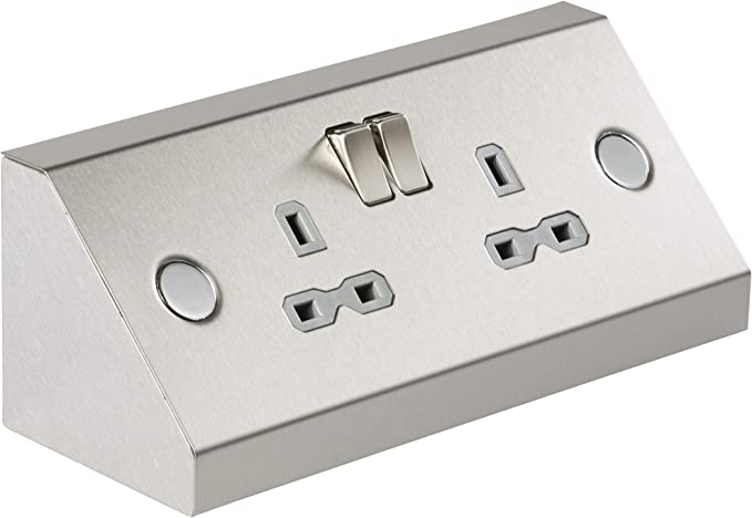

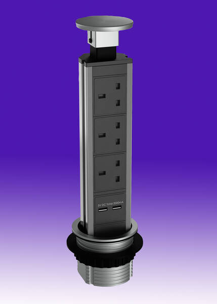

I wouldn't just cut a hole and fit a double socket, the holes will fill with debris and water.
Other devices exist
As to whether you can tap off the oven supply, short answer is yes, if the supply is 4 or 6mm² and 32A it should be fine, if just a 2.5mm² and/or 16A supply you will have to be careful with loads if the oven is on.
I'd suggest fitting a 13A socket or 13A FCU to power the above type of device. Some come with a flex and 13A plug.

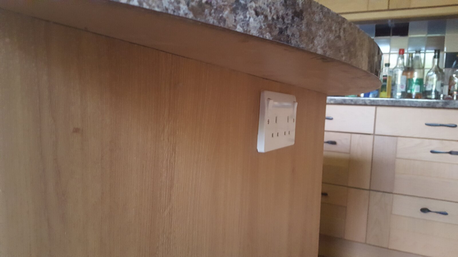

Can you not run a spur that is below the worktop?

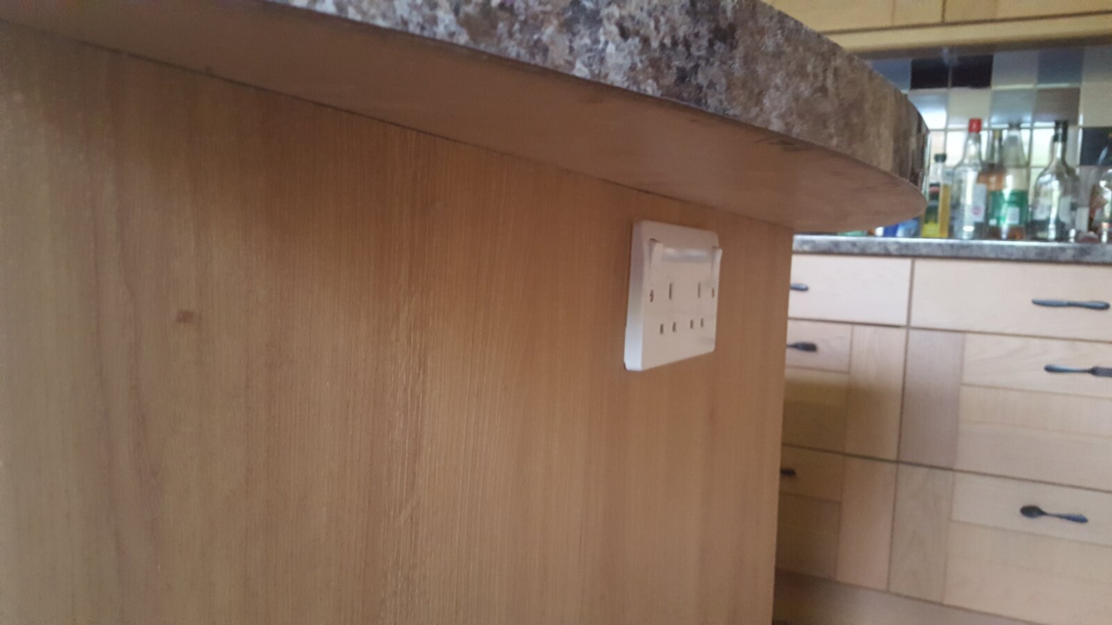

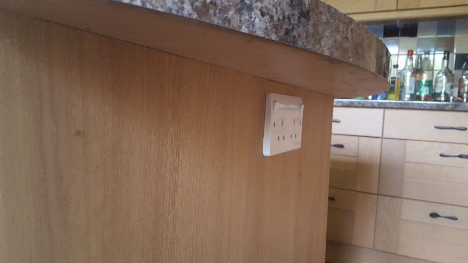

It must be possible to fit a socket in a cabinet side under the worktop like I did20221108_133451.jpg
It must be possible to fit a socket in a cabinet side under the worktop like I didView attachment 284982
I really dislike that arrangement.
Anything plugged in, and standing on the worktop, has a trailing lead looped over the edge.
This provides a hazard such that the kettle full of boiling water can be easily snagged by a passing 5-year old (0r 75 year old!) with terrible consequences.

I would not have it flat that's asking for water penetration, raise it up a bit on a surface mount back box...they come in all sorts. eg
