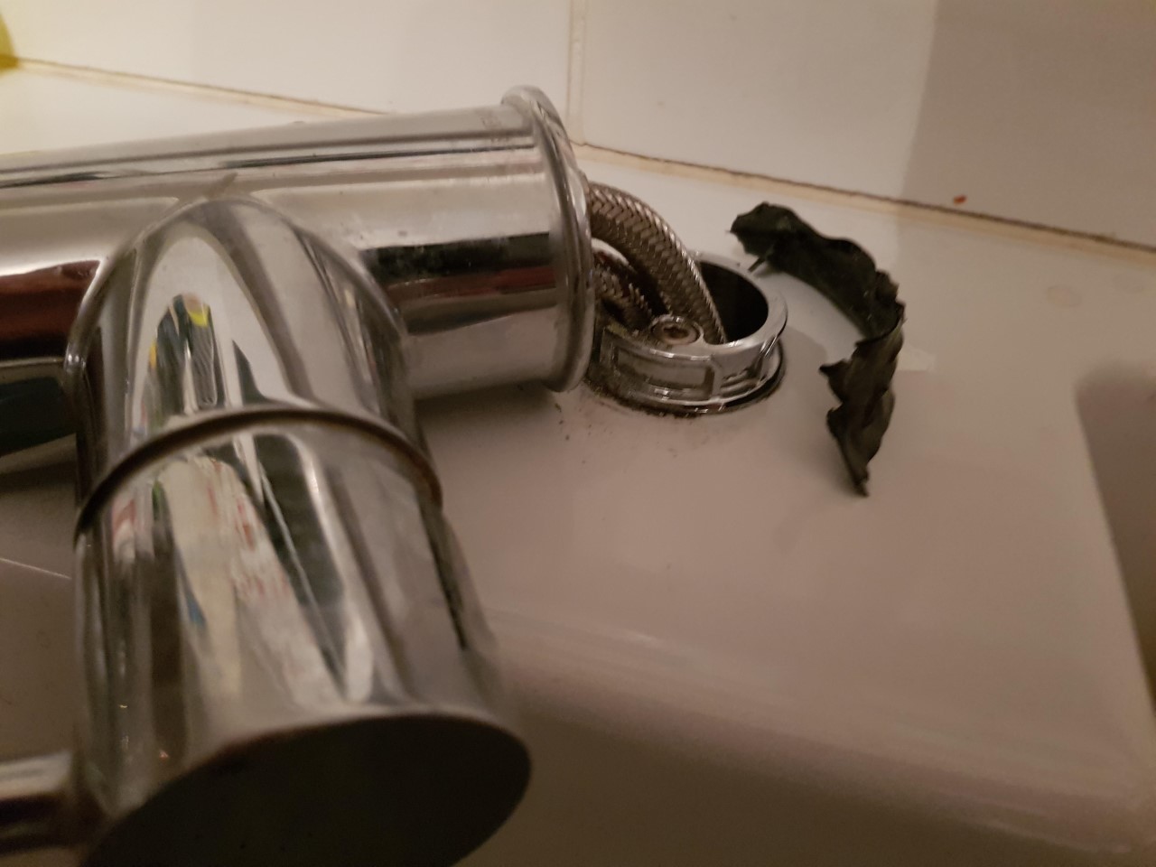

Belfast sink with single mixer tap. Single hole.
I can see some sort of "surround" in the hole. But the main mixer tap sits on top and appears to be secure with a grub screw. Trouble is the hole/thread appears to be knackered.
Obviously, I can't just screw a normal screw in because there are water pipes running up through. I really don't want to screw in too far and puncture one of those.
At the moment I've got electrical tape wrapped around the base bit so that the main tap is jammed onto this but its not that secure.
Considering glueing it all together for now but not sure how I'd ever get it off in the future then.
Any suggestions/ideas?

Where the base (non-swivel bit) is attached to the basin. I'll get pics...

Yes I think this is there. BUT, on top of these fittings there seems to be a "stub". This rises about 5 mm above the level of the sink. The main tap body then sits on top of this (slides over) and then is secured using a small grub screw that screws through the main tap into this stub and keeps it in place.
Not the best design. I can't see if the stub is knackered but the grub screw doesnt have anything to screw into by the looks any more.
Never seen anything like that , need pics, (main body has pipes in it so would not slide onto any base) .
I normally disconnect the waste underneath and pull the sink forward to gain access to the fixing to the tap.
Andy
If the thread in the tap base has stripped, then it can be drilled out and tapped to the next size up. It will be brass so no problems there - but the wall of the metal doesn't look too thick.

Yeh the base bit is plastic. Thats the problem. The screw going is has nothing really to grip into any more......
