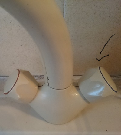

I have a problem with the Mixer Tap in my Kitchen. The Cold Tap seems to be slipping and won't turn off with a single turn.
Is this just a washer that needs replacing or do I need a whole new tap?
If its just a washer how do I open the tap? I have done this years ago but forgot what I did lol.
Here is a picture of the Mixer Tap. Thanks :)
Prise off the white cap with the blue ring around it. There is a screw beneath to remove. Then the handle pulls off to reveal the valve ,which screws out using a spanner.
The spout looks to be cracked ,low down. If it is ,it's probably new tap time .
Is it just a Washer inside? I have a box of standard Tap ones I think.
That does look very much like a Hygena tap from the 90s but no sign of the O ring going so if you can live with that split in the coating there's life in it yet :)

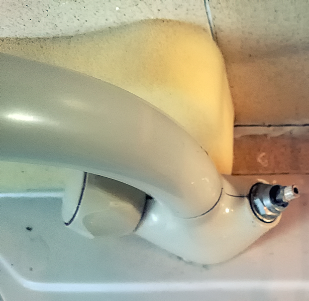

I took the cover off as today it stopped working. The screw that goes inside was loose. I have tightened it up and it seems to be working for now. :)
Just for reference what part do I look for if this does not work?
Here is a picture of the tap with the head off. Thanks
Could be thread/cog on the tap head itself wearing down. Looks like you deserve a new tap.

This is now a bigger problem than what I have quoted above from the first post of this thread.
The old problem of the Screw has come back. This time when I tighten the screw It does not stay tight or if it does I get no water when Cold Tap head is turned. The Hot Tap works fine its the Cold Tap that's the problem one
Any ideas what I can do to fix this? thanks
Its possible that the inner piston has backed off too far on the thread causing your problem.
Isolate supply, spanner on the hex bit you've shown in the pic, wind it out and lets see what is what.
How much would this be for a Plumber to fix? Any Ideas? Thanks
I have never replaced Inserts, pistons etc so have no idea what to buy or how to do this.
Fit a new tap ,yours isn't worth fratting about with. It would probably cost more in plumbers time to effect a repair/ source replacement valve ,even if you can find a plumber who can be bothered to even attempt it.
