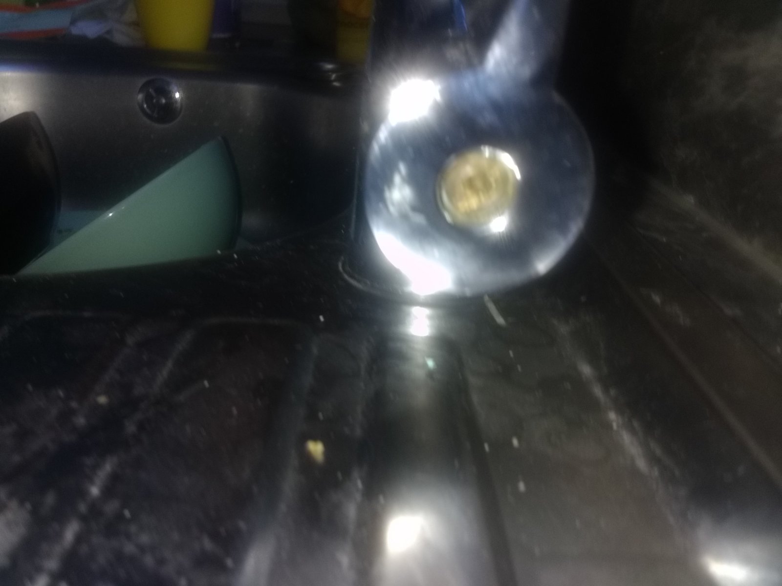

As above, when using other taps the mixer tap in tge kitchen squeaks and leaks. It does stop when the other taps are off or when I give the cold side a little nudge. Now i tried to take out the valve but the screw started to break and i don't think it will loosen without breaking the head off tge screw completely. I've tried WD40 but no luck with the screw.
Any tips please.
If the tap is several years old you should consider buying a new tap.
photos please.
Including of the tip of the screwdriver and the screw it won't turn.
And indicate the part(s) that seem jammed.
There is ,and has been for many years ,more cheap and inferior quality taps on the market than there are good ones. Yours has failed after 8 years , thats not too bad. I replaced one last week ,kitchen tap , only three years old. Customer paid 130 quid for it ,and a very well known brand ,it was leaking through the body of the tap casting and irreparable
Sorry for delay and image quality. As you can see from 1st image, there is a small gap between the cold handle and the body of the tap. The screw in the second image is breaking when using a screwdriver and won't budge.
