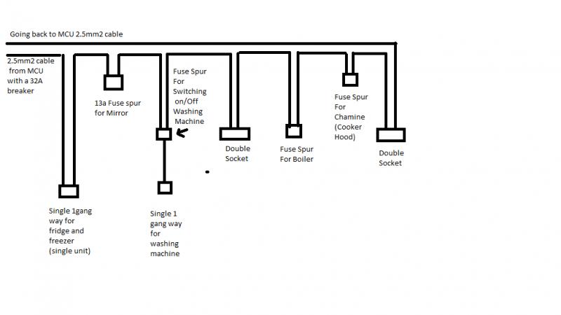

I would like to thank you EFLImpudence for answering my previous question but there is another thing i would like to ask.
I am running a new ring into this outdated kitchen that had only 1 power Socket in it
I am running a 2.5mm2 cable that comes from the MCU with a 32A fuse breaker
Please see in the picture
I am connecting a fridge/freezer(single unit), washing machine, mirror, 2 double sockets, cooker hood and combi boiler
I would like to know if the process meets the Uk standard and if the way i am connecting is fine as i am doing it myself

Get yourself a piece of paper and work out what kind of devices you might connect up and have switched on at the same time, and work out how many Watt's they will use.
For example, deep fat fryer, 1500W, microwave 800W, extractor fan 150W, fridge 250W etc etc.
Take that figure (2700W in example above), and convert it to Current (Ampere)
Power (P) [Watt] = Current (I) [Ampere] * Voltage (U) [Volts]
P=I*U ==> I=P/U
P=2700
U= 230
I = 2700/230 = 11.73A
Work out the length of cable you require, and go to TLC's voltage drop calculator and see if it will be sufficient according to the tables.
http://www.tlc-direct.co.uk/Technical/Charts/VoltageDrop.html
I'm not sure how it works with ring mains as you effectively double up the current carrying capacity of the cable.
Maybe someone more qualified will be able to provide the theory on that.
Also I'd ditch the MCB and get a RCBO instead, Sticking the fridge/freezer on its own circuit is also advisable as they can often give earth faults, or the other way round, if the power trips in your kitchen whilst your away at least the fridge will remain on.
The boiler will go off and the pipes freeze up ;)
If you are putting in separate circuits then I would consider give Boiler priority over fridge freezer . Better still both on separates.
I know its only a sketch and maybe the cable lengths are not represented but try to spread the load around the ring or a least make most of it around the middle one third with regards to circuit length. Good design is to try to ensure, as far as reasonably practicable, that both legs draw similar amounts.

1) The law requires you to obtain Building Regulations approval for this work before you start. You have to submit an application to your local council.
As part of that you'll have to explain what you'll do to ensure that your work will comply with Part P of the Building Regulations.
You can read more about it here: //www.diynot.com/wiki/electrics:part-p
2) I don't know where you will be running the cables, but if they are going to be concealed you'll have to consider the requirements for that:and the affect that burying them might have on their current-carrying capacity. Reading all of the sections in 4.3 of this guide would be a good idea:
http://www.tlc-direct.co.uk/Book/4.3.1.htm
For a ring final the cable has to have a current carrying capacity of at least 20A.
You also have to satisfy yourself, as designer, that you won't be overloading any section of it for long periods.
3) You'll need to carry out several tests on the circuit, both before and after energising it. These must be carried out in the correct sequence, you'll need to buy or hire the equipment, and you'll need to learn how to use it, what each of the tests does, why they are done, and what results you'll get if it's OK.
http://www.tlc-direct.co.uk/Book/8.1.1.htm

Also don't use fcu's (fused spur - sic) to feed sockets, use 20A double pole switches.
quote]
sorry to intrude, just picking up tips! why would you use a double pole switch over a fused spur 13amp spur? just curious. thanks
2 sockets in a kitchen is totally inadequate.
If that diagram represents the actual wiring layout, it needs to be changed to avoid that long length of cable from the last socket to the consumer unit.

Yeah that will be a mirror connected
The last socket to the MCU it is a 6 meter cable
another thing is that i run out for breaker on my MCU( i have only 4 breaker)
1 dedicated to the cooker
1 dedicated to the lights
1 dedicated to sockets in the house
and this spare one that i wanted to run this ring
Your help is much apreciated
