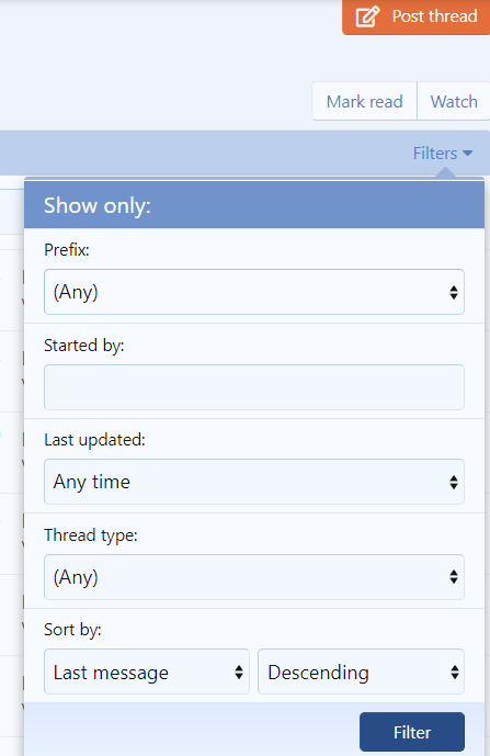

How come they are showing in order as if they are recent threads on my laptop? I honestly thought I was replying to recent threads.
