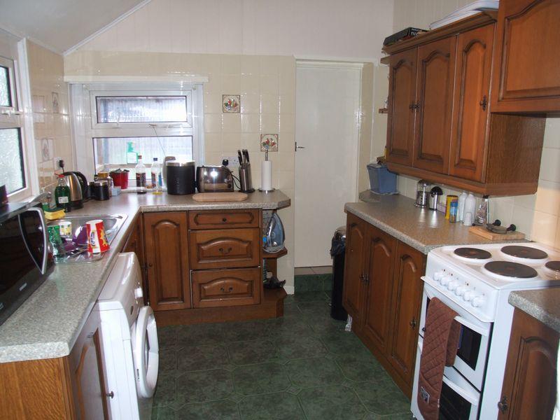

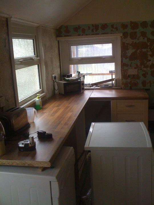

So this was the kitchen on the estate agents advert.

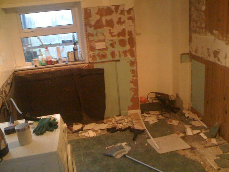

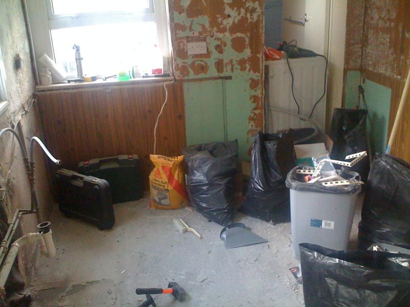

And this was it last Saturday after having fun with my new Bosch-2900-FRE on rotary stop.
Floor tiles came up dead easy.
Tile adhesive not so easy. Strangely enough, I actually had better results getting it up with a 5lb lump hammer and bolster chisel, the SDS dug in a bit but the bolster sort of lifted it off.

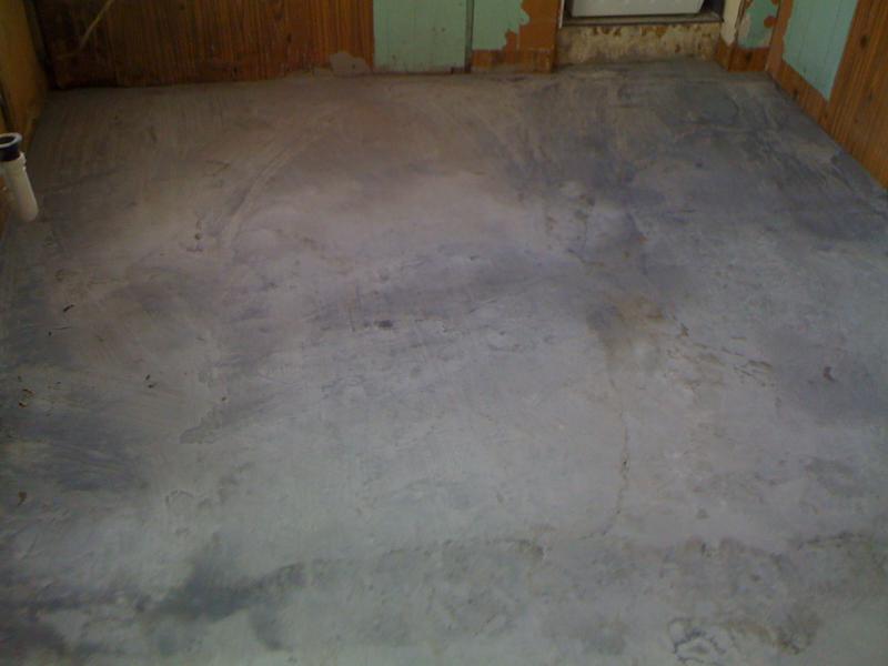

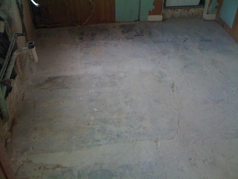

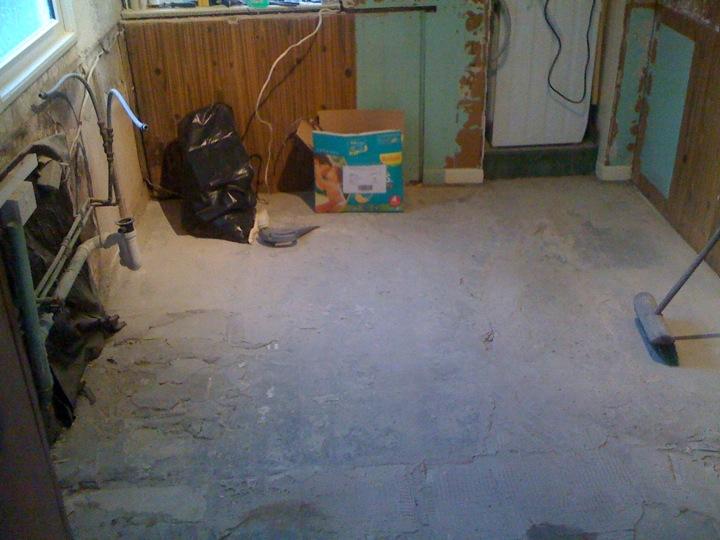

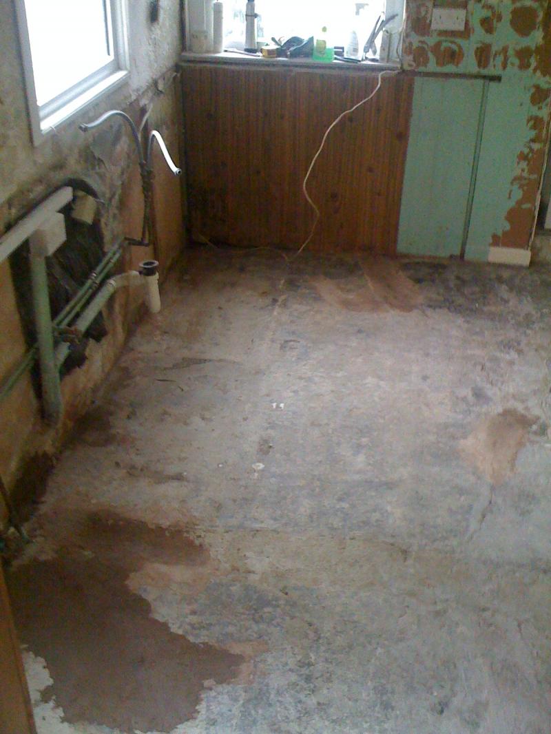

So this is the floor as it looks this morning, tonights job is to get the very last of the adhesive up around the door and any other high spots I find, give it a good sweep and mop out. Then a layer (or two?) of PVA.

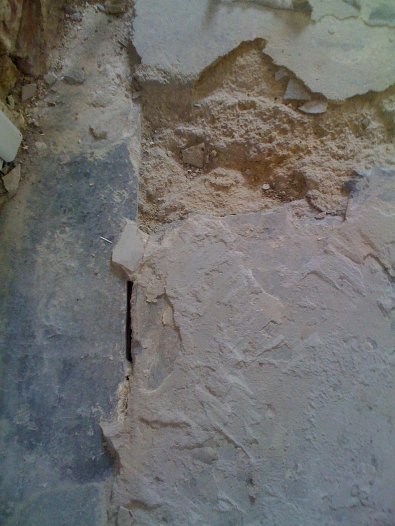

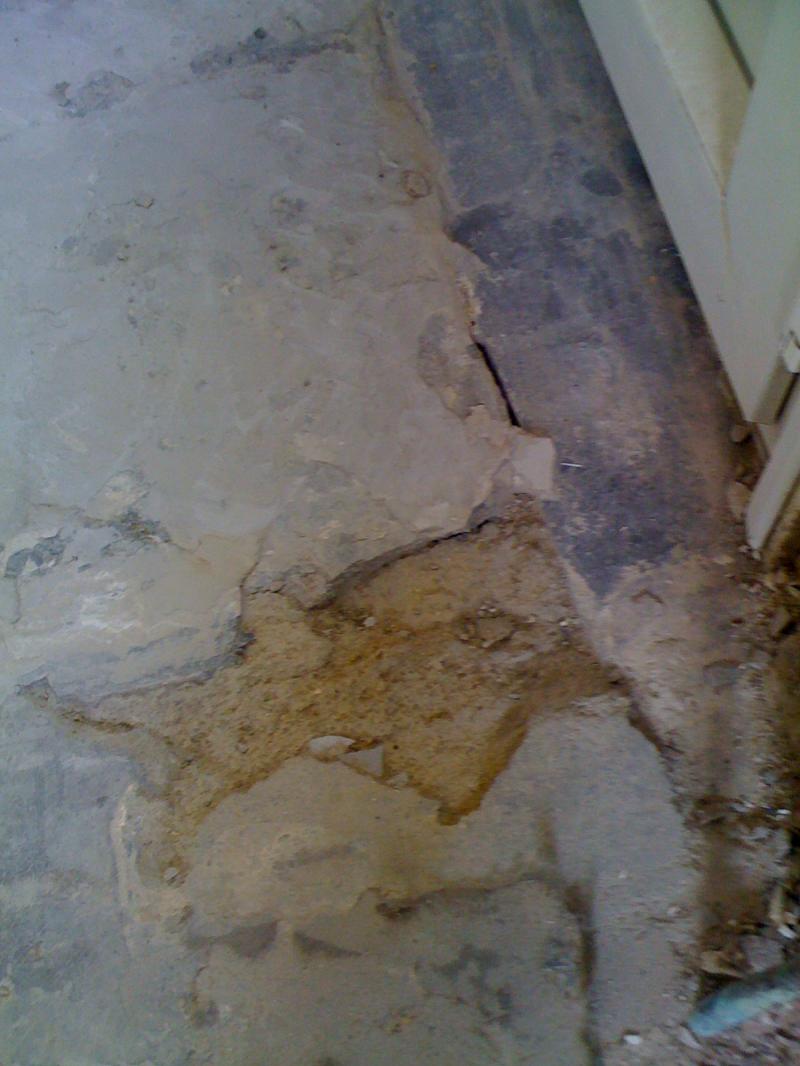

I’ve bought some Sika latex self levelling compound to level the floor out as we want to put vinyl flooring down, I haven’t used SLC before so there’s a bit of trepidation but before I actually get that far I need to do something about the holes I’ve uncovered near the door. I’m guessing the SLC isn’t designed to fill this sort of thing as it’s loose and a bit crumbly. I’m thinking it may worth be applying PVA and then using something like Hanson Sand and Cement Mortar in there. That’s about a fiver for 25kg in B&Q.
I also want to PVA the left hand wall where the crumbly old DPC sheeting was and paint it with Everbuild 901 bitumen paint. I’ve also bought some B&Q insulation roll which is plastic one side and silver the other. There’s only one baton on the wall so I’m thinking I might be able to bond it on.
