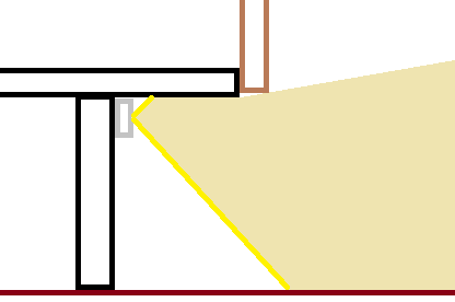

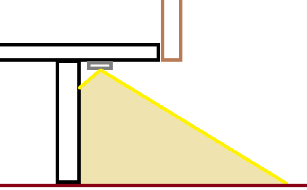

No worries, Mount tape like this:
not this
As Eric says it will fall off soon and even sooner in option 1but in the meantime the lit plinth and floor looks nicer than option 2.

Many thanks sunray , I like the idea option 1 just one thing seems to be a stumbling block , I have a built in dishwasher with pull down door and it looks as if it will interfere with the strip lighting as you can imagine what is the place to stick to on 90% of the plinths becomes a moving object via the dishwasher , any ideas how to get over this .

If there is a suitable place to stick LED tape to match the rest then the option is to cut a seperate piece for the DW and have a 'flying lead for it. You will have to ensure it's secured to something other that the tape or it will fail very quickly.
