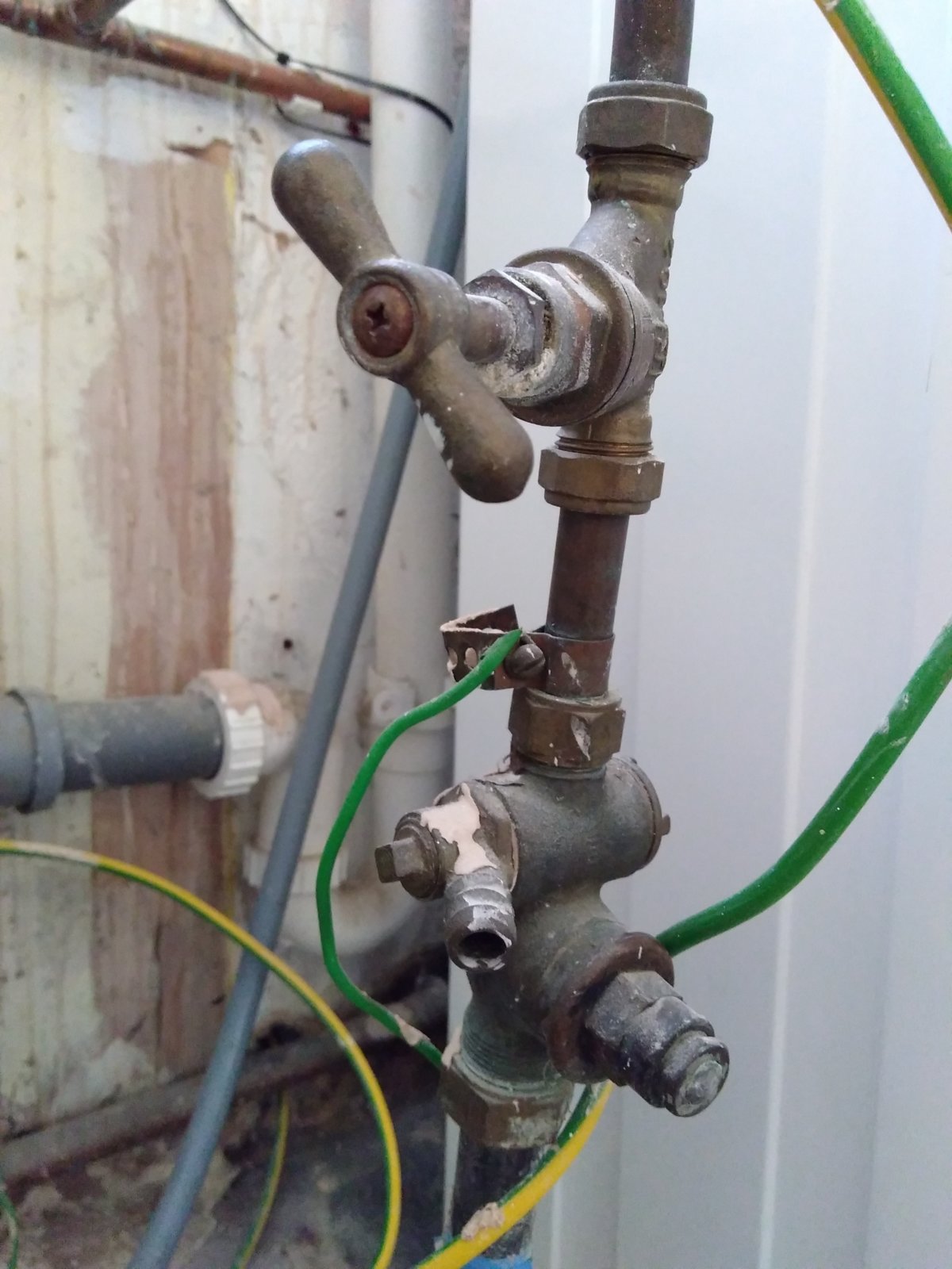

also, i don't think that i have one already (see enclosed photo)

Is that a snapped dual valve mains tap with the integrated drain off? I presume that the mains flows upwards and your working mains stop tap is at the top of the pic? Can't see what's above that ....anything?

correct - yes, the mains flows upwards
there is nothing after the stop tap

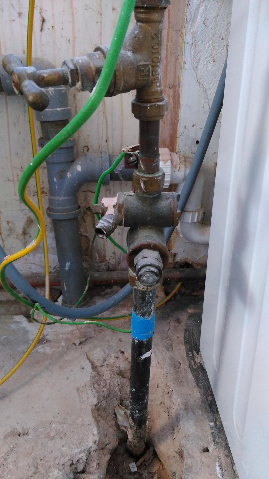

re: "is that a snapped dual valve mains tap with the integrated drain off ?"....i have no idea but here is a better photo so awaiting your advice
If it is one of those, what's its purpose and do i need one ?
My plan this weekend is to turn off the water at the end of my drive, empty the system, make a clean cut of the black akethalene pipe, attach a Philmac connector to drop it down to 15mm copper, and redirect the akethalene pipe so that its flush with the floor back to the wall (rather than just sticking up in the middle of the kitchen) and then fit a new stop tap

Yes that's an old integrated valve, if you're going to cut the alkathene down and re-do it all then no bother with taking all that away and renewing. the drain off should be above the stop tap or downstream of the tap. Might be easier with a full bore WRAS approved ball lever valve, rather than a stop tap.
I wouldn't cut it flush with the floor, it's useful to have enough to get hold of, for example if one day you need to replace the valve you're about to fit. Especially if the end needs trimming again.

To be clear, I plan to cut as little off the Akathalene as possible so i can have a nice smooth curve under the unit and leave plenty to play with and as you say, in case i need to trim it back in the future
