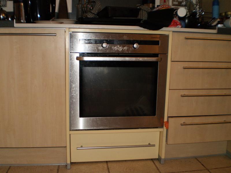

Next question this is my oven
//media.diynot.com/182000_181147_42281_59438507_thumb.jpg
2)Is there a way i can get a black gloss door hinged to the trim or is it to thin .I need it to go cover the oven all the way to the floor.
