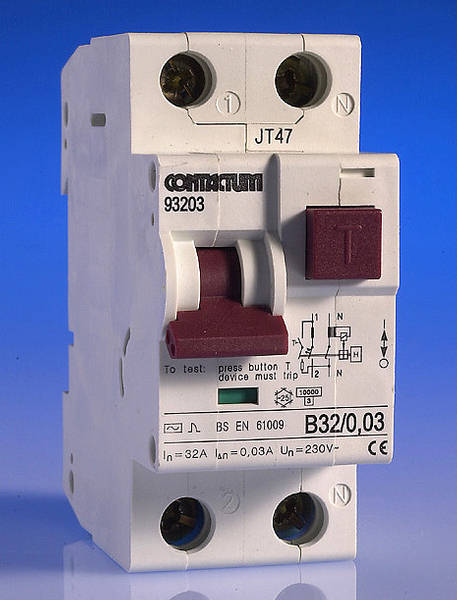

About to put in a seperate ring for the kitchen seeing how it's about to be demolished. At present we have a 30ma rcd that controls the two ring mains (100amp main supply), should I add another for the kitchen or will a 35amp mcb be ok, I have the space in the c/u,(I think I know the answer to this one !!)

This 80A RCD (question 1 answered!) means it can 'monitor' a max of 80A of current at any one time. This is probably quite adequate but remember that an RCD does not protect against over current so a 32A MCB should be installed in conjunction with this. This RCD can be used along with an additional MCB to protect a new Ring.

the 80a d/p rcd is protecting all sockets in the house, 4N + 4L, take me back to the old fuse boxes ! 35 mcb for kitchen it is then

Put me glasses on in daylight and realised it's one of (or v. similar) to one of these

In #4 you post a picture of a 32A 30mA RCBO

Not one ring, theres two, 4N + 4L into this gizmo which is 32A 30ma (told ya I'd put me glasses on !!), made by wylex stamped up mcbrcd and takes up two spaces, hence the rip it out and replace with two 35a mcb's.
Think best to wait until I fit new c/u, as some of this wiring is a bit weird.
Ah - the mists are clearing.
Two rings from one RCBO - that is odd. I'll bet that it was originally 2 rings from 2 MCBs, and then someone decided to add RCD protection, found that RCBOs are twice the size, and so had to amalgamate the rings.
Whatever - yes you can split them as you said, but that'll leave you with no RCD. If you're planning a new CU, wait until then.
