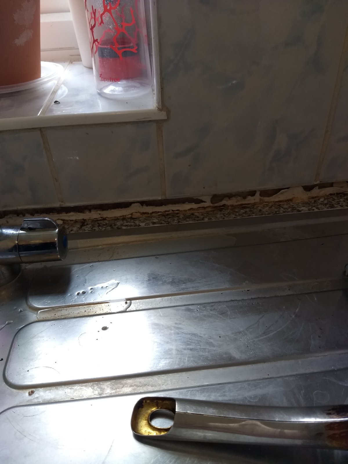

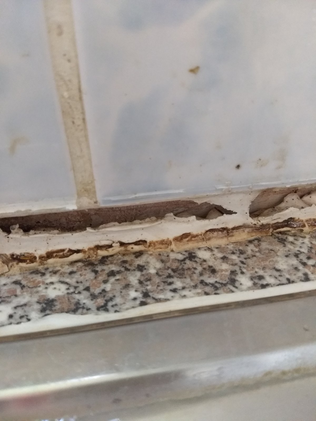

The bodged sealant (at the back of our worktop where the sink is) has eroded and basically fallen apart, leaving a huge gap between the tiles and the worktop. Pics attached.
The space is too high and far too deep for me to use a regular sealant gun on it.
Any suggestions? Some sort of cavity filler or foam that hardens?
Any suggestions gratefully received
Cheers

looks like somthing has dropped for it to be stretching like that or that worktop is rotten
Thanks for replies. Yes, I can now see it's definitely dropped at some point. I'm gonna boost it up with a bit of wood, then use some sink/bath sealant tape once I think it's not moving anymore.
I don't think it's rotten, just poorly constructed!

theres no upstand/splashback ,the mottled material is the work top. the tile is the splashback.
dont be messing with the unit legs, youl give yourself more problems.
that sit-on sink might be allowing water under the rim because its not properly siliconed down. or not even clipped down.diy'ers sometimes leave the clips loose or off because its awkward to get at them behind the bowl.
the sink cut out in the w/t has left a thin strip of work top material.water might have rotted it, as mentioned abov, or weakened it so it sags.when installing w/t's we always use a strengthening length of wood to support that weak strip.
maybe you can glue and screw and prop a length of reinforcement below the w/t?
if the w/t is rotted then sack it and renew.
clean out the existing sealant and sqeeze a thin bead of siicone on the wotk top and then propup.then another bead of sealing silicone to seal between the tile and the w/t.
laminate w/t's should be sealed on all cut-outs and raw edges. the long back edge can be sealed with a glue on edge strip. b&q do rolls of them
