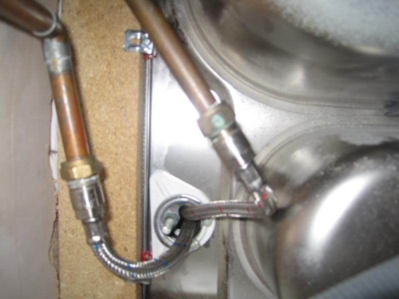

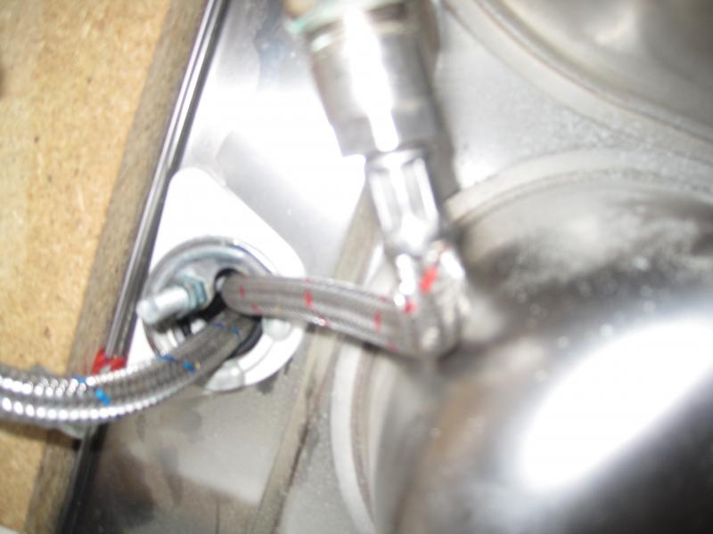

My kitchen sink tap needs replacing. I have attached a couple of photos. Questions:
(1) Do I undo the flexible tap hoses at the cope pipe joints (compression joints) OR
(2) Do I leave the flexible tap hoses in place and somehow undo the hoses at the base of the existing tap, which is currently out of sight. If so, how are they attached to the base of the existing tap and what tool(s) / other bits & pieces do I need for the job?
Many thanks for your useful advice.
Mutley56
[/img]
undo copper to flexi nut, grab hold of flexi and if you're lucky it will unscrew. repeat with other and undo nut on base of tap. if flexis don't unscrew, undo nut and draw tap up through worksurface and unscrew or cut off. you will probably need a tube spanner to undo the tap retainer- can get at any diy store.

That is probably the easiest bit.

You will really struggle to undo at the tap end, if done up tight after reassembly there should be no problem. Good luck.
Right.
Turn off isolation valves leading to the mixer tap, I take it they are fitted?
Turn on hot and cold to make sure the water is off.
Undo the flexible tails connectors from the copper pipework, NOT FROM THE TAP. Water will come out but only half a cup full.
Undo the mixer tap from the sink with the box spanners I showed earlier.
Lift tap from sink, and pull out the flexible connectors.
Refit as above in reverse.
Apply some LSX on the compression joints when refitting the flexible tails to the copper pipe work.

Problem, I couldn't undo one of the flexi tap hose ends at the point where it joins the copper feed pipe. The other pipe and flexi pipe undid easily.
As a solution, I thought of cutting off the flexi pipe and purchasing a new longer one as a replacement.
This seems straight forward and so I think I must be over looking something, am I?
Thanks for your thoughts.
Mutley56
You need two spanners or grips and hold one side still while you turn the other side anti clockwise. It will give and come undone, eat at least 3 shredded Weet before hand.
