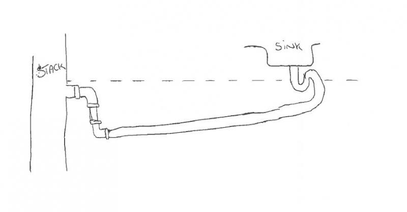

Hello,
Im new to the forum and just after a bit of advice before my kitchen gets fitted. The waste pipe for my sink has to be back against the wall for the units to fit. the only way this was possible was to route the pipe work like this.
Will this cause a issue where the vertical part is next to the stack pipe? or will it be ok because it is still below the water line in the sink?
its only a 2mtr run and its all in 40mm pipe.
Hope someone can advise.
Thanks Don
Is it possible to turn the trap 180° to avoid what I've circled in red so the pipe follows the black line? Will that create a fall to the boss?
To do it your original way really needs a new boss fitting lower on the soil stack.
As Charnwood - Fit a P trap to the sink. On no account do it the way you have drawn. Fit a new connection lower down if you have to.
I think I will just drill another hole and buy a strap on boss.

In my case the boss and the insert were separate parts and the chaps at plumbase helped me out with the right one. I used solvent weld but I believe that push-fit and compression versions are available too.
I used a hole saw and my cordless drill - mine was a 50mm version. Took about 5 minutes and I was on the top of a 7m ladder.

The strap on boss is initially a 50mm size and you use a solvent to weld it to the stack. Check the strap boss for actual hole saw size
Then you need the adapter to fit into the boss to suit the waste pipe size which in your case will be for a 40mm waste.

Wickes have not got a clue on the answers to using on a cast iron stack - You can't use a PVC strap on in that case! But you will be OK with PVC
Thanks for that, I was just looking at that on the Wickes webpage. Is the solvent weld easy to do. I guess you just put it on and let it do its thing.
I also seen this in Screwfix that requires no solvent glue,
http://www.screwfix.com/p/mcalpine-mechanical-pipe-boss-connector-black-40mm/55722[/QUOTE]
A good idea, McAlpine make good products so I would use one as well!
