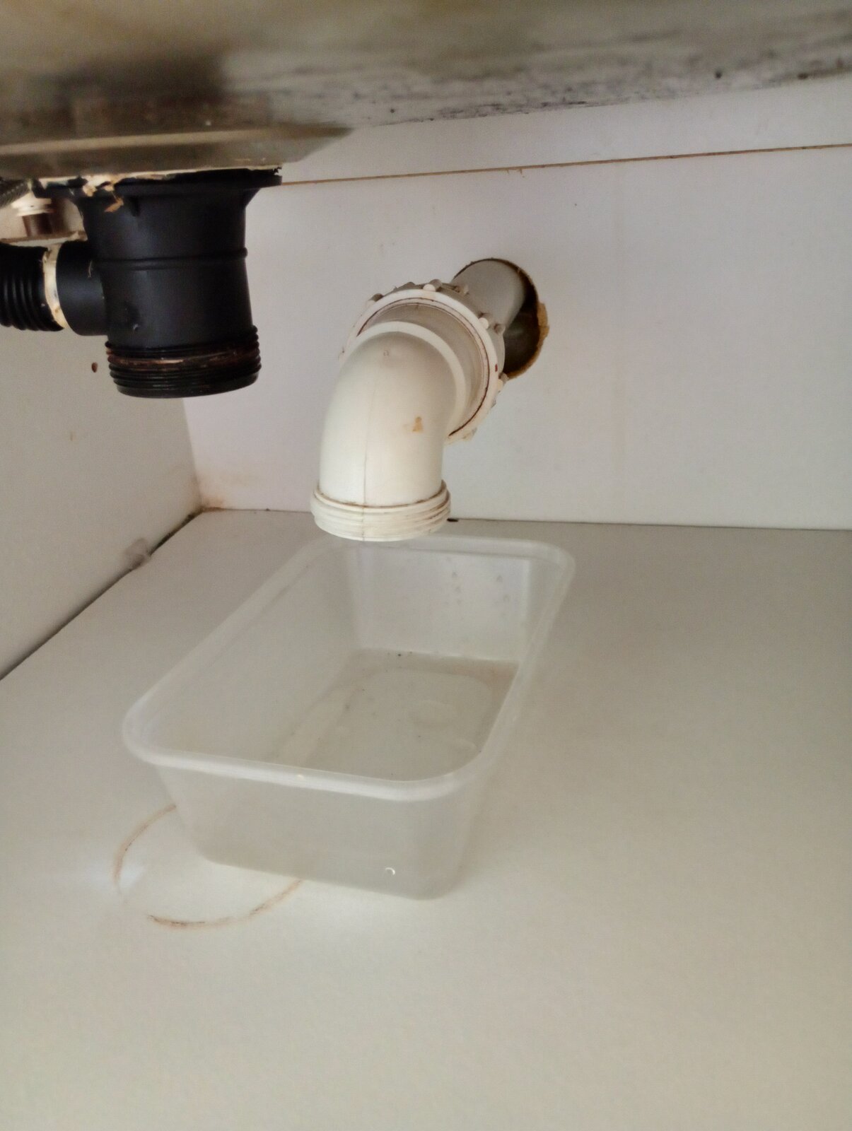

Daughter has developed a bad sewage type smell in the kitchen. I've replaced all the sink drain plumbing, but the smell is still there. This weekend I spotted a hole in the cast iron soil stack (as shown approx on image) behind the pipe next to the wall. On inspection this was the same smell and there were a couple of chunks that were loose which I have removed. Obviously the stack will need replacing at some point, but my question really is could this be the source of the smell? How would it get from here through the wall and into the kitchen? The smell does not seem to be anywhere else in the house.

The top of the pipe is damaged too (and open) so may have been higher, but the smell is not upstairs only in the kitchen. I changed the p trap and outlet pipe under the sink but not the sink plug unit or overflow. No dishwasher and the washing machine has a separate outlet.
I'm only there at the weekend so can't post photos till Saturday but I replaced a shallow p trap with a new deeper p trap and all new outlet pipes.
Actually, the p trap is missing here, but this was the set up, replaced all but the black outlet from the sink. Pipe runs straight outside and to the drain cover.
It may be the angle and perspective but the waste pipe looks narrow. It should be 40mm but if its 32mm and there was only a shallow trap its possible that the trap was being pulled by self siphonage when the sink empties.

The sink starts at 40 but steps down to 32 for the outlet pipe. Replaced it all a week ago and the smell is still there. Seems to be worse when first going in.
Temporary repair to the soil stack with duct tape until it can be repaired or replaced should rule it in or out as the problem.
My money would be on the trap being pulled though. Reducing from 40mm to 32mm is very likely to cause suction on the water in the trap. You could try an anti vac trap but, ideally, the waste pipe needs upsizing.
