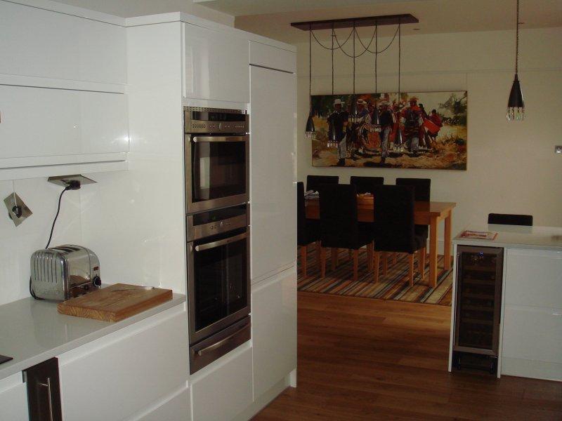

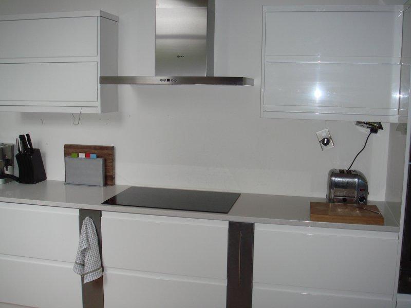

one of my jobs.
First class workmanship in the securing of those sockets.... ;)
Seriously though - they should NOT have been energised in that state.
the glass splash backs werent fitted at this point.
So they wanted glass splash backs, but didn't want to pay for a proper job, and ruined the appearance of the whole thing by fitting those disgusting sockets.
And anyway - under-cabinet sockets - wow - so what?
What about under-cabinet grid switches? Under-cabinet cooker switches?
I didn't fit the sockets, the electrician did.
That's what the customer wanted and was happy with the result.
The other switches were mounted to the right of the fridge freezer unit.
