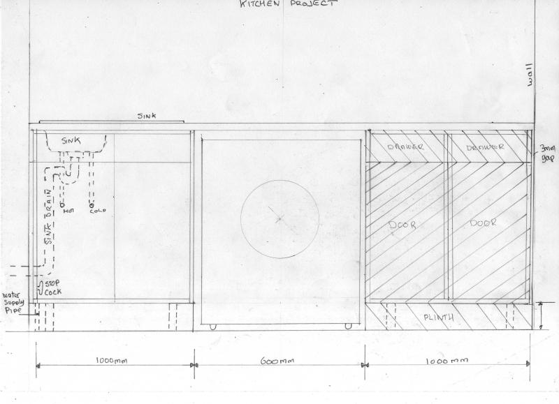

I'm using a set of base cabinets for my kitchen. The washer will be in the middle, and either side will be a space of 1000mm.
To the right of the washer will be a 1000 wide base unit.
Now, I'm not sure what to do with the 1000mm space on the left of the washer, because that is where the water supply enters and waste leaves and where the sink will be.
I have two options for the left: Fit a 500mm base unit just left of the washer leaving me to figure out the 500m space left of this base unit, or fit a 1000mm base unit.
Would the usual thing to do be to fit a 1000mmm base unit on the left and to cut out any necessary holes in the base unit? As per the drawing I've made. Thanks.

The normal approach would be to fit a 1000mm base unit, with appropriate cut-outs. If it looks really untidy you could always cut-out parts of the back of the cabinet and form boxing inside the cabinet from MFC (melamine-faced chipboard) or Contiboard, edged with iron-on melamine edging tape (trimmed) so it looks neater when you open the doors. Silicon seal the worktop/wall joints and make sure you install a silver foil worktop protector on the underside of the worktop where your washer will go

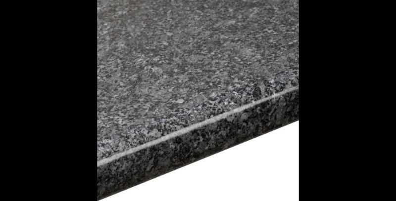

I was thinking of buying 38mm IT Kitchens Black Quartz Laminate Round Edge Kitchen Worktop:
Product code: 03261200
Technical specifications
Finish Quartz effect
Surface Finish Gloss
Colour description Black
Profile 10mm round edge
Length 3m
Depth 600mm
Thickness 38mm
Base material Chipboard
Timber certificate TT-COC-003110
Timber approval FSC® approved
Maybe see if you can get a bead to match. Would the tiles look odd if the bottom row were 10mm shorter? Are they patterned or plain?

Tiles are plain. 150mm square. The bottom ones would be 140mm high, or show as that height, if the new worktop top surface rises above the original level by 10mm.
Of course the worktop would stick out at the front about 8mm more than originally.
Looks easiest to just butt up the worktop up to the tiles. And put a quadrant at the junctions.
