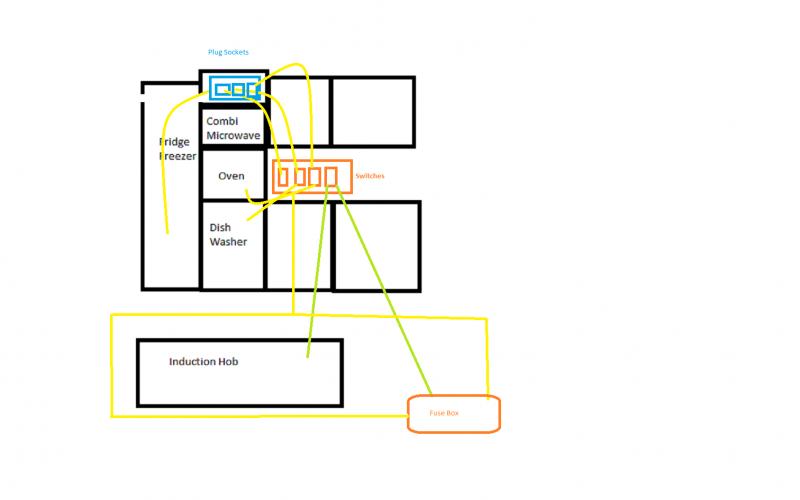

I've done a little reading and wanting to know if I've understood things, before I speak to the electrician and look like a real numpty.
In the kitchen the Fridge/Freezer, Oven, Dishwasher and Combi Micro can all be plugged in.
I believe they should have switches (maybe not all, but if doing some, why not all).
Induction Hob Hardwired
So was thinking a nice matt metal plate (grid?) of labelled switches.
Ok
Is the below diagram correct?
My basic understanding is that the electricity come from the Fuse Box, to the switch and on to the socket then the device?
Or with Grid Switches, do these replace the Plugs and have the devises hardwired into them via a fuse?
Cheers in advance
Up to you. It's not a requirement.
Could not be included. It should already have a 'cooker' switch.
This is a requirement.
Sort of.
Yes, obviously will involve considerable rewiring.
No, nothing else changes - just a cable from each appliance socket to grid-switches.

Just to add more detail, I am renovating, so bare brick walls, pre plasterboarding and new electircs going in.
So I could have 1 large Grid plate with 5 switches
Induction Hob - Separate wire from FuseBox to Grid to Appliance?
FridgeFreezer, Oven, Dish washer, Combi Micro - All plugged into two double sockets neatly hidden in spare cupboard above Oven/Micro Stack. With the electricity coming from FuseBox to Grid Switch to Sockets?
No, the hob will require a (normally) 45A switch suitably placed and not hidden within two metres of it for isolation and use in an emergency.
The grid-switches are just for convenience but, if in a cupboard, why bother.
I presume you will be able to obtain a matching one.

Ask your electrician to use steel conduit for the cooker circuit, and a CCU without a socket, then you won't need it to be on an RCD.
Ah right, I see, quite obvious.
So if all the sockets for the appliances in the same stack (and fridge next to it) are being placed in the cupboard above the stack, then there is no need for a Grid Switch in the first place. (just seen them in a few managed apartments and magazines)
So the only visible switch is for the Hob
I always recommend them to customers. It's not a great deal more work to fit a grid switch, and it's really handy to have.
No need for them regardless of where the sockets are. Totally unnecessary and the majority are probably never used.
Their only real use is to accidentally switch off the freezer or fridge and ruin all of the food contained within.
