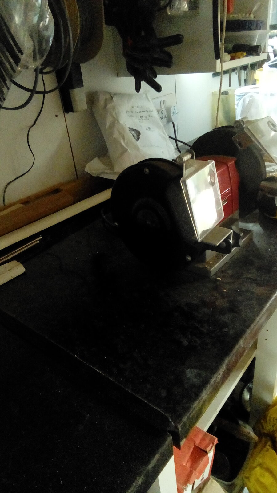

I have worktop as my bench. You just need to think about how much bashing you are going to do.
I also have second hand kitchen worktop as a bench in my shed. I don't hammer the living daylights out of it but, I imagine that with proper support, it would take a good bashing.
My bench is about 4 x 3 feet
It's just 18mm chipboard cut from a single sheet and glued/screwed together. 2x1 timber as edging
I have a 2' square of steel if I was babging on it. 4x3 frame and legs plus a 6" vice
Kitchen worktop is ok but I wouldn't buy it for a workshop- if it's free, fine
They’d crumble surely if made of chipboard?
It's any kind of leverage/twisting I'm worried about... they're pretty rugged under compression? Of curse you can buy solid wood worktops but then the cost saving is gone... unless you can find someone getting rid of one in a refit.
Go for a freebie on gumtree as regards to the kitchen worktop. Mark out where vice will be and cut this out of the the sheet of mdf then screw on the sheet 12mm mdf to the worktop. When it totally knackered unscrew and pop on another sheet.
