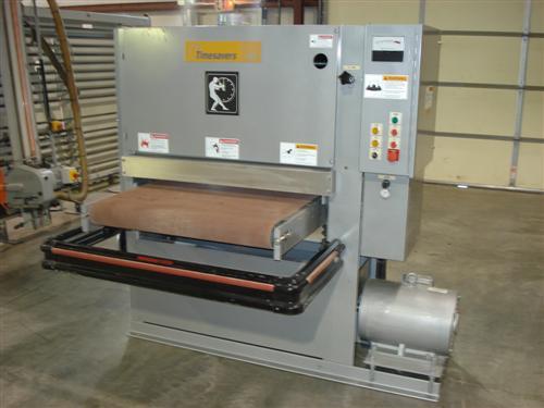

I agree with B-A that narrow staves are more stable, but they're also more work. IMHO they don't look as nice as wide stave, but that's just personal choice. If you go that way you really will need to make sure that all your staves all have the same MC. You'll also find it mighty difficult/time consuming to deal with the inevitable joint issues you'll get, especially if any time elapses between planing and glue-up. It's worth noting that a worktop manufacturer deals with these by running everything through a large wide belt sander several times - I mean one of these:
(about 8ft high and £25k and upwards)
