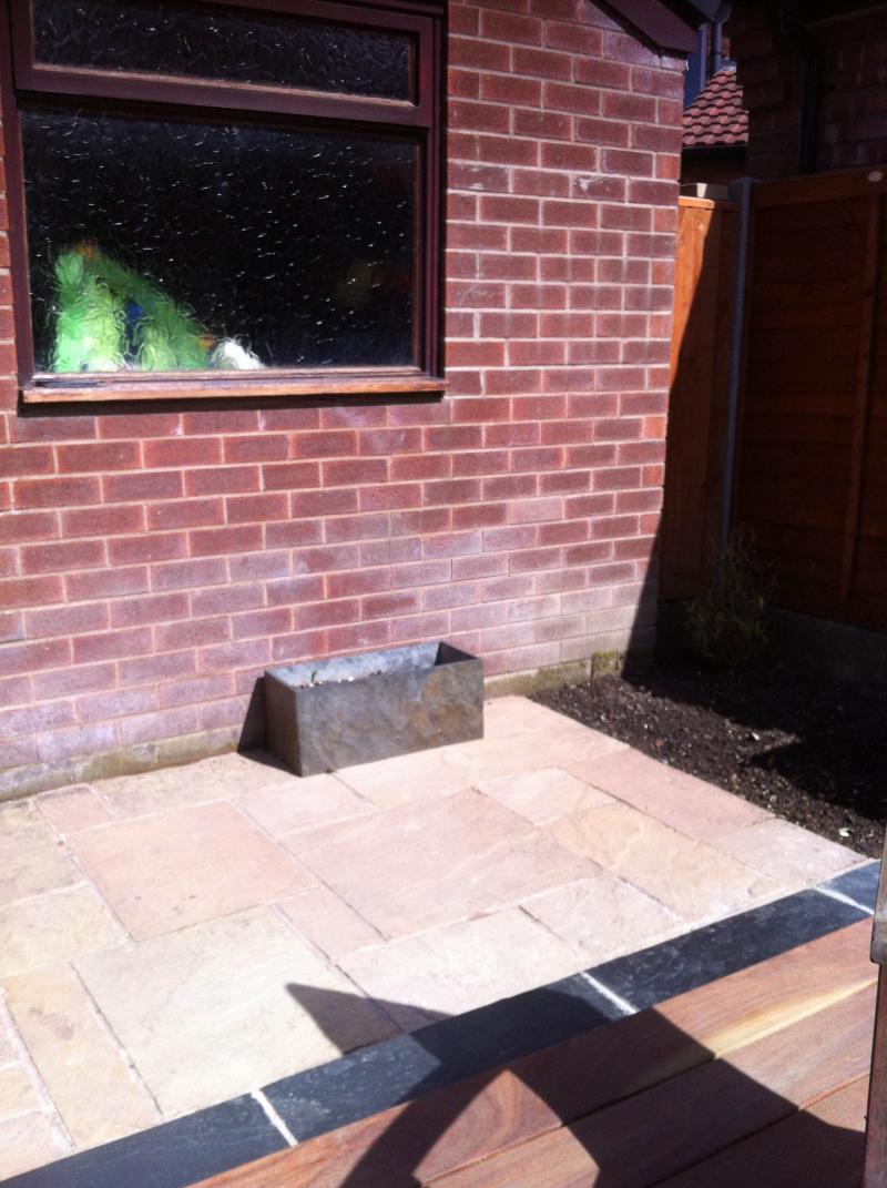

and would now like to turn my attention to the rear of the garage that is facing it.
As you can see from the image below
the brickwork isn't great and there's been some leaching from when all the excavated soil was piled against it. I'm looking to clad the wall and get a climber growing up, whilst at the same time fixing a worktop just under the window that will integrate my bbq, something akin to this
My questions are:
1) Is there any wooden worktop that would survive outside? I'd keep it covered from the rain but it will obviously suffer from temperature swings and high humidity.
2) If there is a worktop that would work how could I attach it to the wall? (I was thinking a number of M10 bolts drilled from the inside of the garage straight into the worktop.
Cheers
Ideally you'd need something like teak or oak to withstand outdoor use.....the likes of kitchen worktop would break up in no time. Maybe a salvage yard could be an answer?
Your fixing idea seems fine, but a couple of peg legs at either end will be necessary for a stable job.
John :)
Stainless steel?
Could be integrated nicely with the BBQ...
