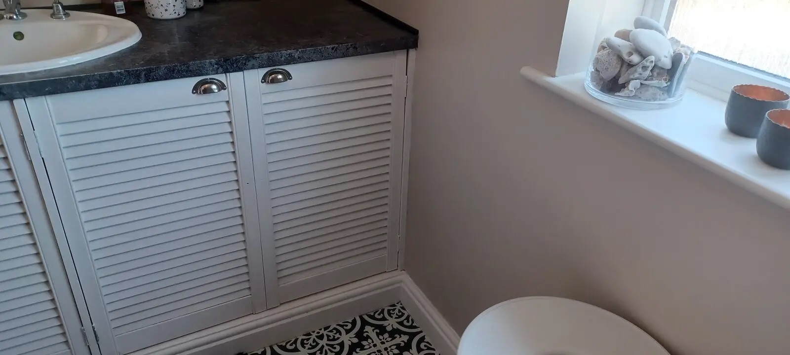

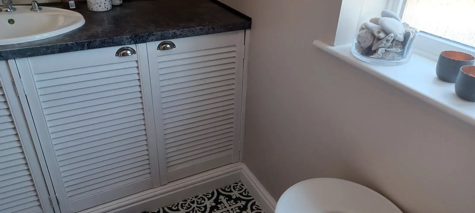

Used this in a bathroom on a single run of 'worktop'
Not too difficult to fit with a bit of care.
Only two adults in our house.
It has picked up a couple of marks in the few years it has been installed.
More likely to get damaged in a kitchen.
If you have a 90 degree joint in the worktop this might be tricky to make neat.
Fitting around sink and hob a bit awkward

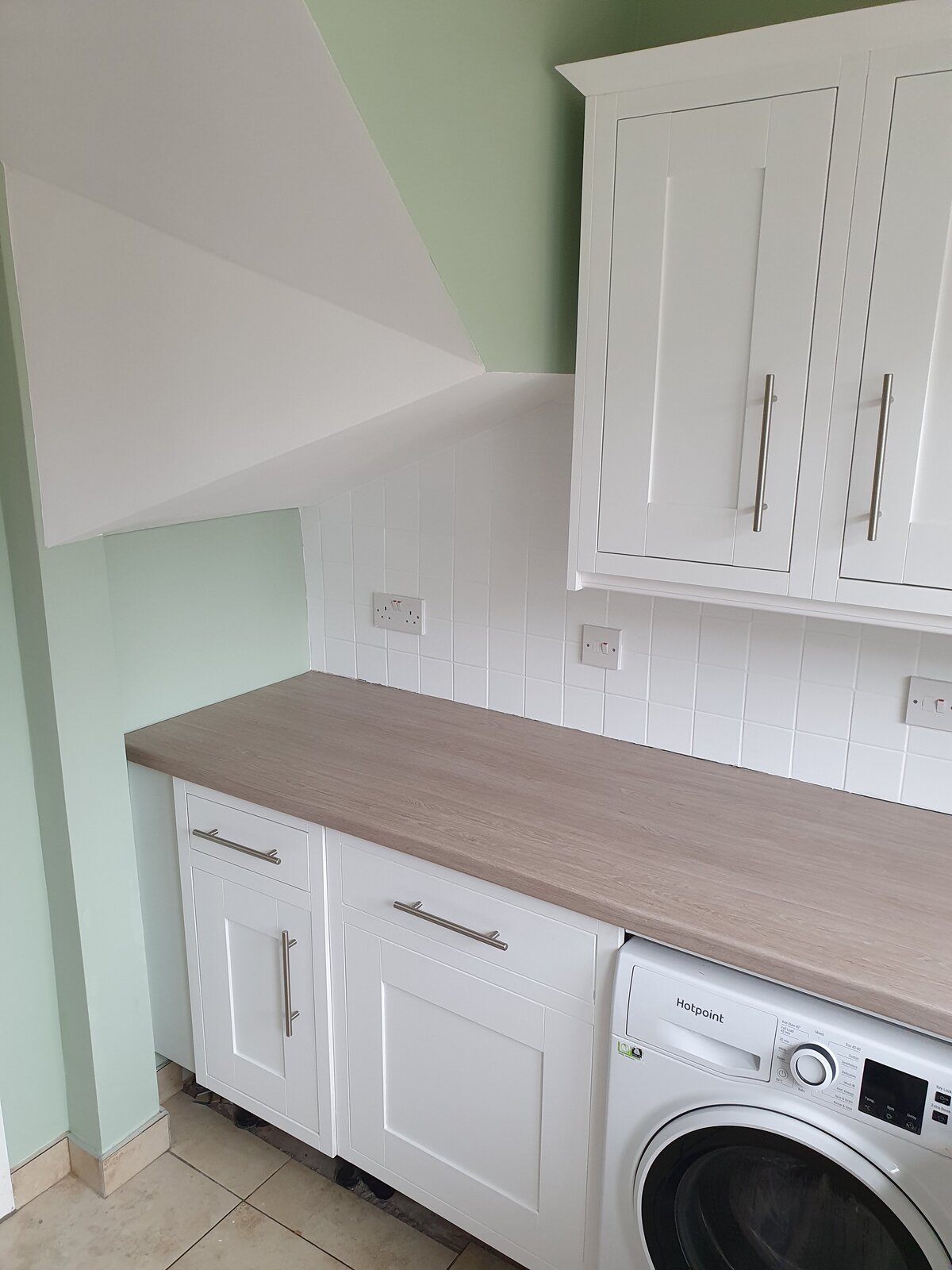

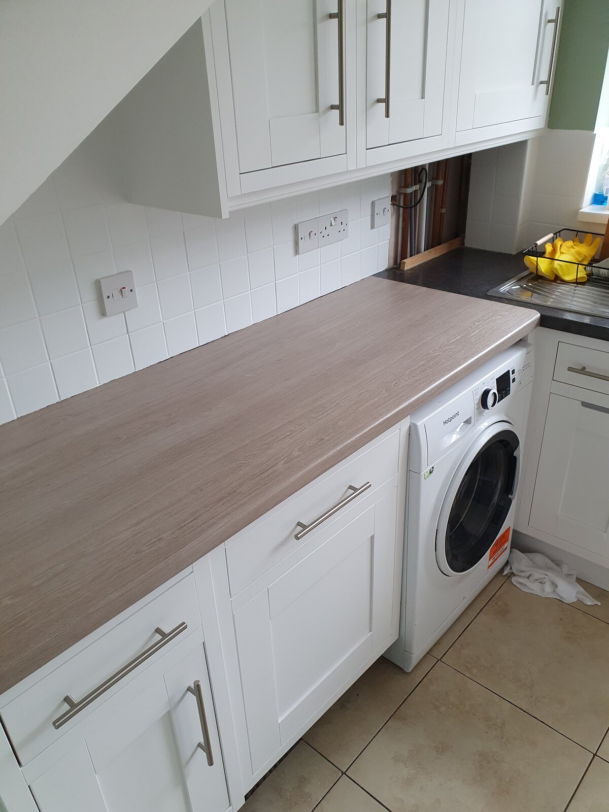

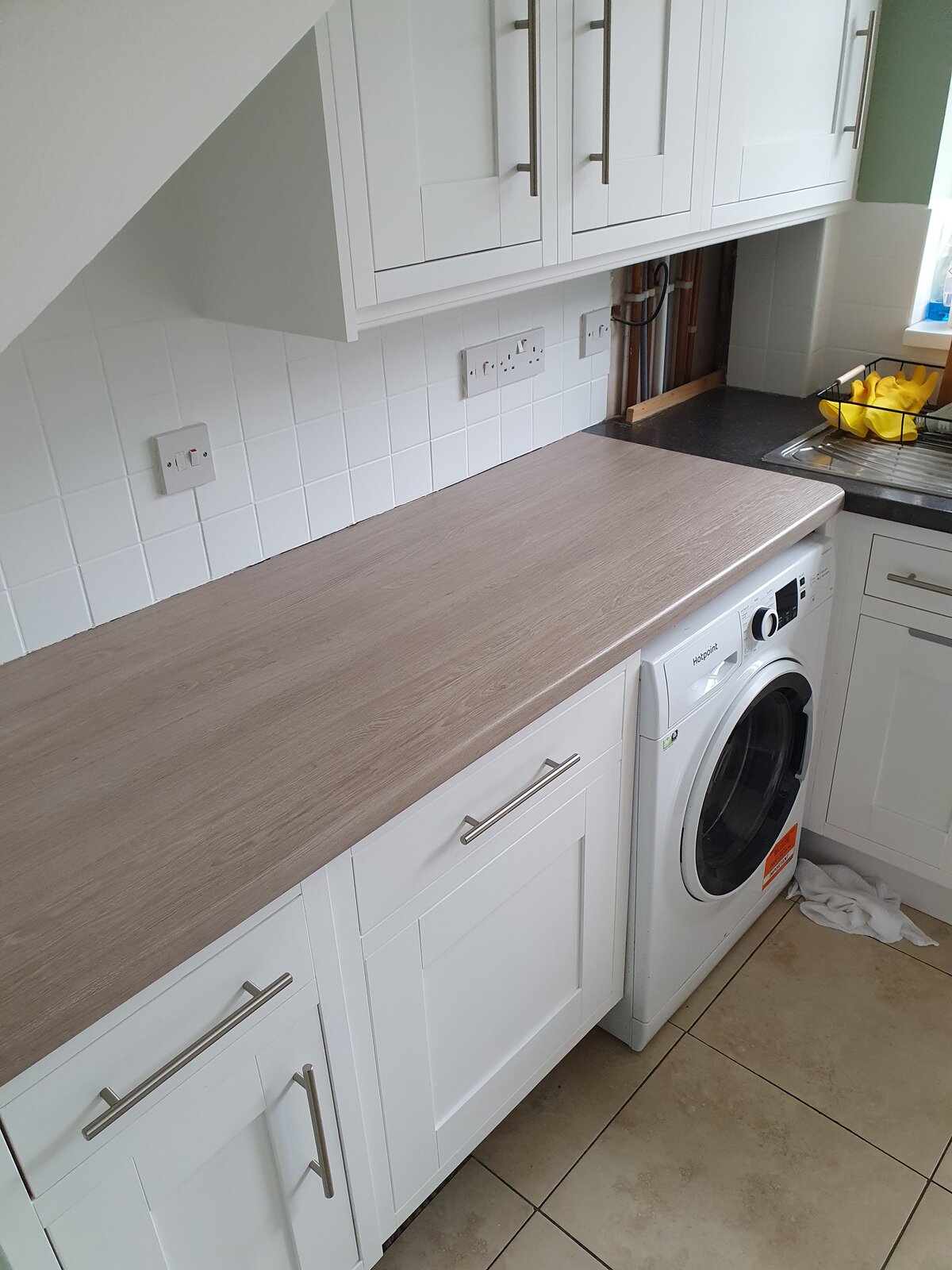

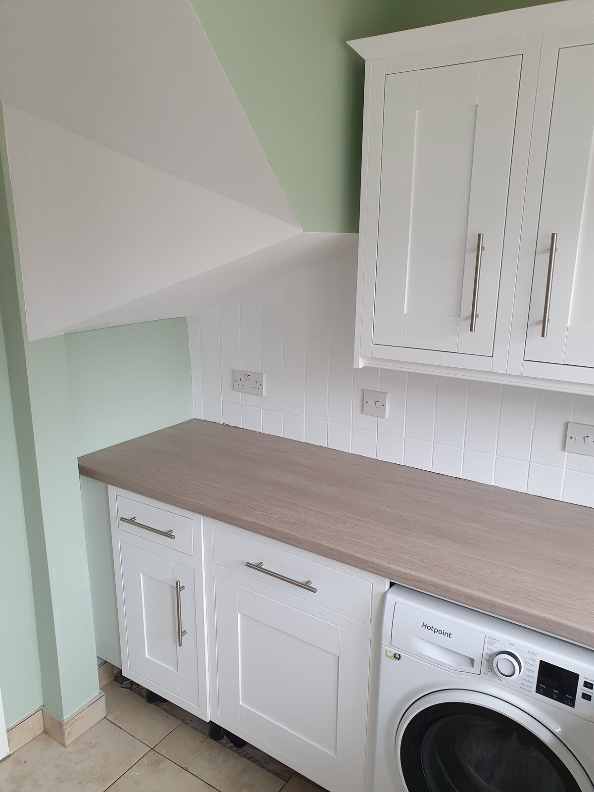

Hi. I recently refreshed my kitchen. Painted the cupboards and tiles. And used a wrap on the worktop. Didn't find it too difficult to do, just worked very slowly taking the backing off and using a smoother to get the bubbles out a couple of cm at a time. It's visually done the job. But it's not hard wearing. Has some scratches and marks already so you'll need to be really careful woth it. I stripped off all the old sealant and redone it after the wrap was on. I'm pleased with the result and was fairly cheep make over.
