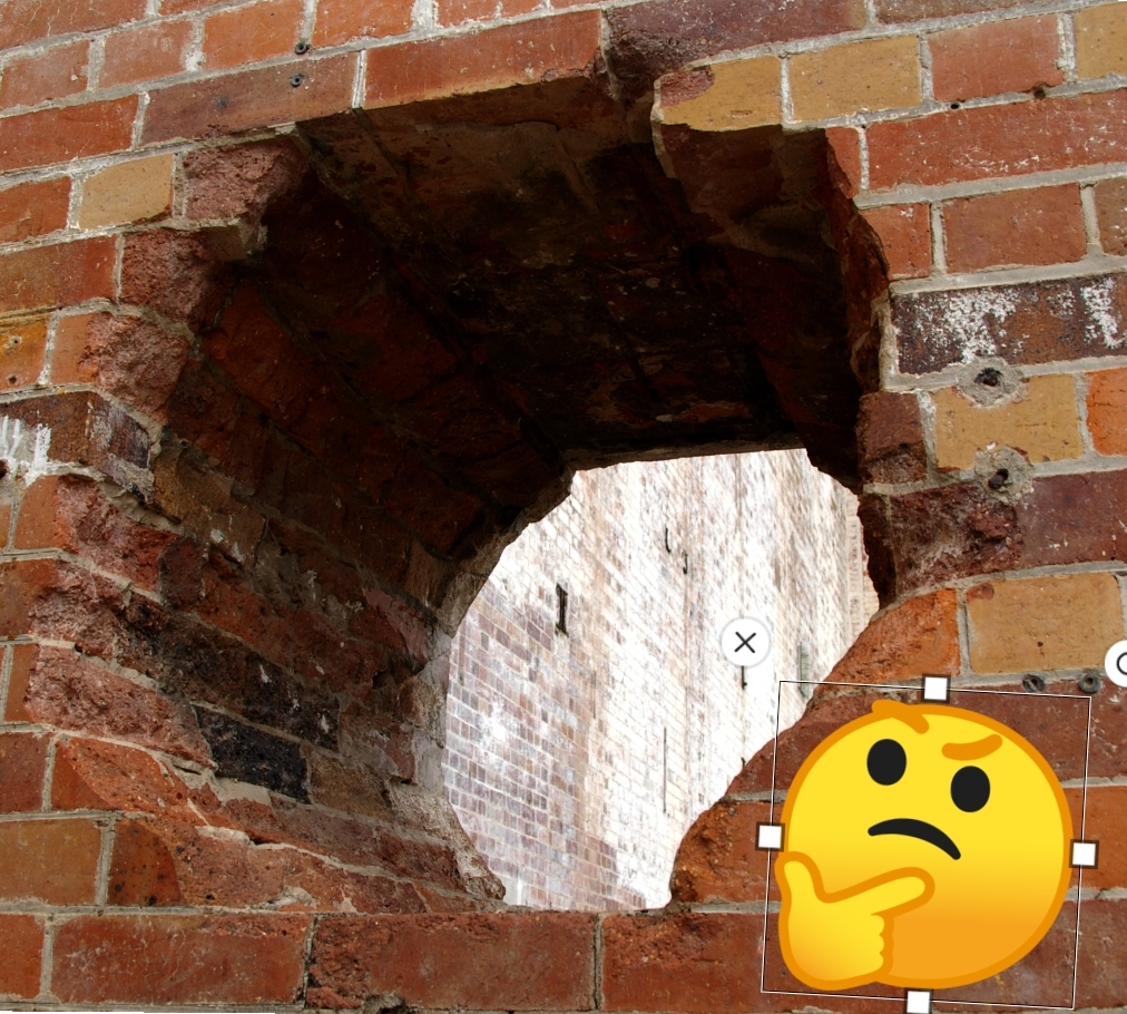

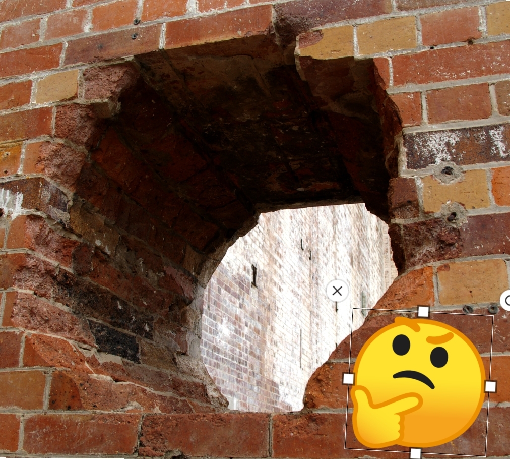

That's what happens when you use a howitzer instead of a core drill
