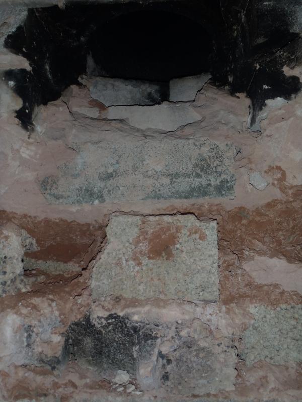

Hello,

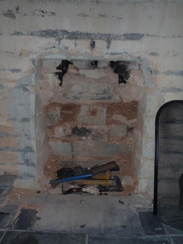

I am having a woodburning stove installed and am trying to prep the firplace as much as posible before it is fitted.
My house was built in 1996 and had a coal fire installed. The flue, pot and stack have all been checked and green lighted for the instalation.
I am trying to work out how much I can knock out of the fireplace. I have taken some photos to try and better describe my situation.

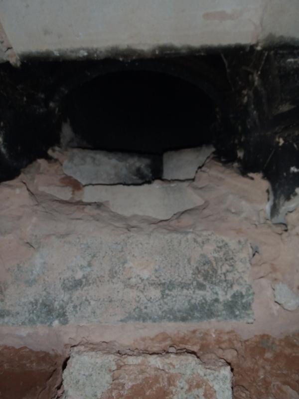

Behind the fireback (which I removed) it seems to be filled with dodgy block work held togather with a very week/sandy morter (see photo). I would be quite happy to just knock it all out but it seems the flue is being supported by the top blocks (see photo).
Ok to knock the shoddy block work out or will the chimney/house fall down? And what sort of thing can I expect to find behind?
Thanks in advance for your help.

I’m not saying you didn’t explain yourself perfectly well; this topic comes up so often that I put together a standard post which will cover or provide links to mostly what you need to know. It’s not intended to cover everything or be critical of what you’re doing, just be sure to follow & read all of the links as there is bound to be something in there that will be relevant, if only the refinishing/plastering bit.
It’ very difficult to make out what I’m looking at from your pics & TBH it looks like a bloody mess but the flue liner, chimney & certainly your house ain’t gona fall down. For greater efficiency of your wood burner, you’re going to need a new insulated twin wall liner anyway; my advice is also to go for a multi-fuel stove.

I have not read through Richards links but would say that when removing firebacks I have seen all sorts of crap used to build out the void behind it. Given the age of your property I really would not expect it to look like that as part of the builders orginal opening. So if it is loose I would pull it out anyway.
