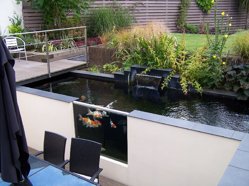

I have just got planning through for an extension onto my house.
The garden at the front is at ground floor level, but at the back it is a couple of feet lower.
So one idea I had was to build a koi pond a couple of metres from the house and then bridge the gap with decking or similar. I'm thinking of something similar to this photo...
Firstly what depth of water do I need?
Secondly, would it be wise to build over slightly with the decking to give a shaded area?
Thirdly, does this also have to have planning/building regs?

You need 1.5 depth for Koi.
Koi don't really need shading and any plants will be eaten.
No planing or building regs.

I guess it's doable then if I dig down as well. I'm guessing I would need fairly substantial footings to stop the sides from giving out?

My pond bottom is 250mm of concrete with the walls built with concrete blocks laid flat.
You will also need a bottom drain-this is very important.
