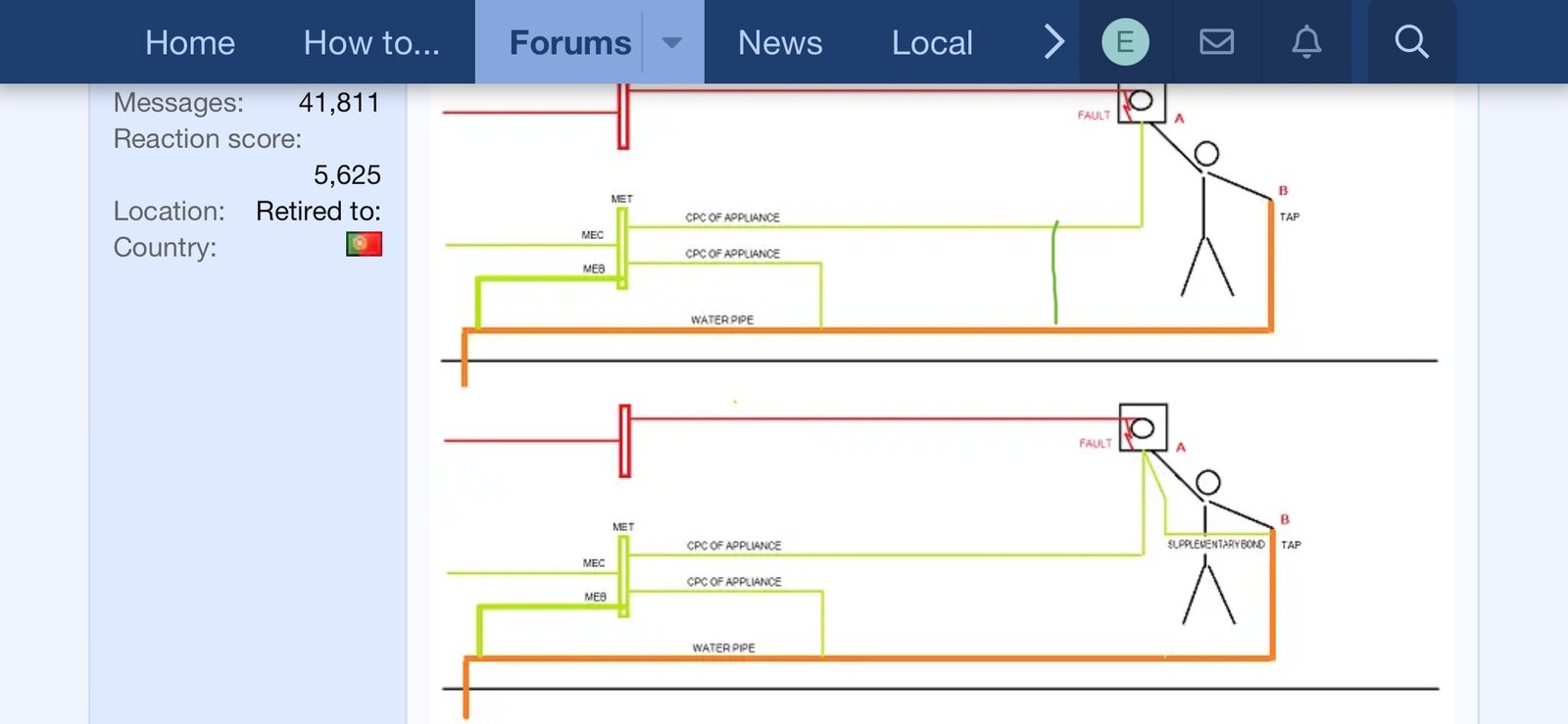

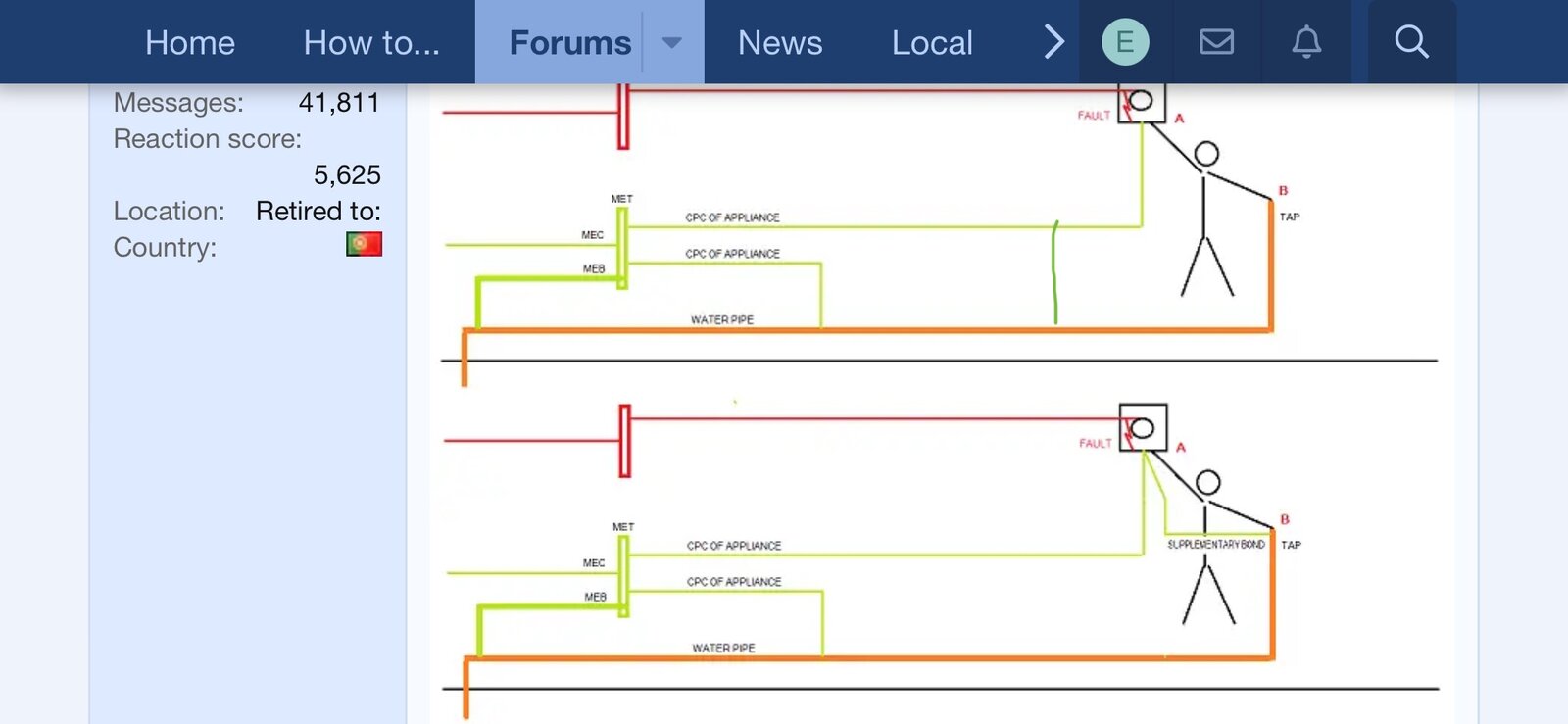

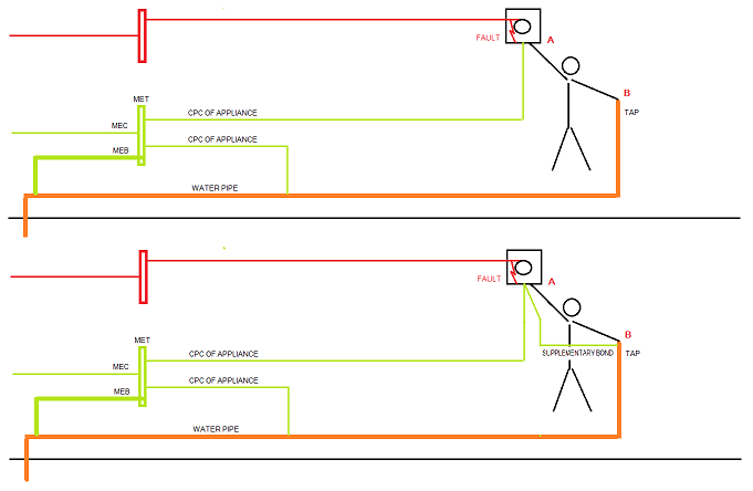

Couldn't find any suitable diagram so - is this any help?
What will be the voltage between points A and B with and without the supplementary bonding.
Still thinking about this !!! You have conveniently drawn the supp. bond at the point of touch, let’s say the tap. If the supp. bond was connected at say the floor level, electrically this is no different to without supp. bonding in place in your picture other than a negligible additional resistance of the pipe work /cpc/meb is it ?
Think of yourself as a resistor. In the first picture you're the highest point of resistance between the voltage on the enclosure and the taps path back to earth. Meaning you can consider the volt drop to be entirely across your person.
In the second picture you're a parallel path, meaning you have to consider the entire cable as a resistor. The voltage will drop equally across the whole path back to earth meaning there will be little difference between the voltage at the fault and at the tap.
That’s assuming the bond is made at the tap itself other than in reality some other point in the pipe work
