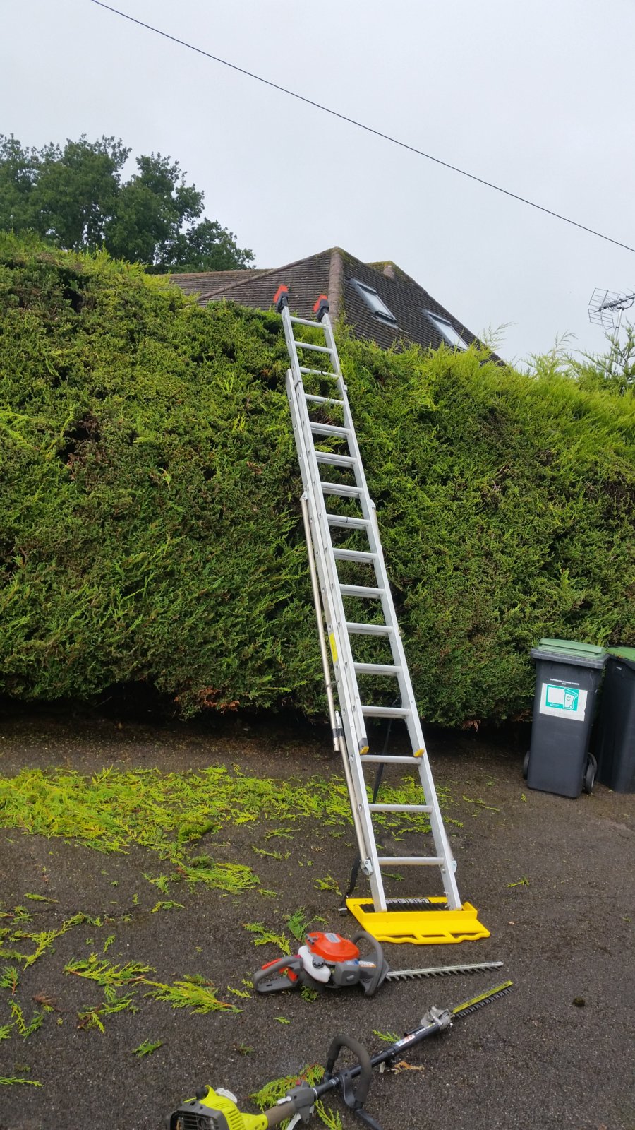

I was using this ladder to cut the hedge and the ladderm8. When I was at the top it slipped back a bit. Is it because of levers? I mean if u push the top of ladder won't that reduce how secure the ladder is on the ground?
Also, looking into the tripod ladder. Anyone got any experience of this?

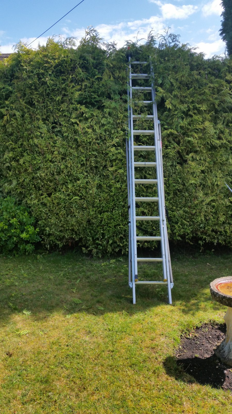

In the other photo the ladder sinks into the hedge too much.

If you set a ladder up at too shallow an angle, it will slip
Never tried it but fixing a "snow shoe" plate to the ladder may stop it moving into the hedge?

You need to use a ladder that is similar height, ideal 6" less than the height of the hedge. As you say you lean forward at the top and it creates a pivot point where it rests on the hedge. The issue with this is every hedge is a different height.
The far better solution is a tripod ladder. They are very stable even on the 3 Ste from the top. They are also very confortable to use as they are steps not ladder rungs so you get a better footing. Add in adjustable back legs and they are great on slopes.
My best ever hedge cutting purchase, if you are doing this as a job it's a no brainer. As a homeowner ita harder to justify. I'll be using mine later today.

Handyman so do gardening part time. Got the ankalad stabiliser on the hammer in pix. But that cant be pushed into the hedge. I guess the tripod one can have the front pole 'pushed into' the hedge itself so the top comes out further into hedge. Is it better to get the higher one and use a normal ladder for lower levels? Adjustable feet surely worth extra money

They are great because as you say you can sink the rear leg into a hedge. I have a 14ft one and its good for high hedges upto about 18ft. If you dont do too many high hedges a smaller one is better and easier to use on average 10ft type hedges. too much ladder above the hedge just gets in the way.
I have one with only the rear leg being adjustable and have never come across a situation where I couldnt make it work. The 3 legs adjustable type would be easier on slopes but as i said you can usually get it working one way or another.
If i had to have one for general use a 12ft would probably be most useful but at the end of the day too big is much better than too small. Bare in mind transporting them too, a 16ft is very wide at the base.
