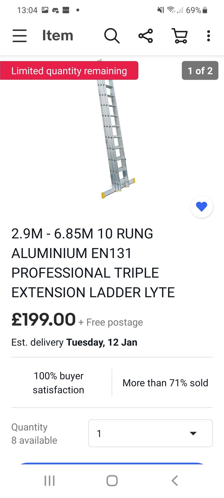

Is this best bet?, is the standoff just a universal fit job?.

What’s the safe working weight - can it safely carry your weight plus whatever you may be carrying with enough of a safety margin? Yes, the standoffs are universal.
It's 150kg , I'm 80kg so all good there.

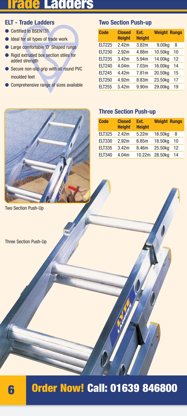

It's the ELT330, can't find Safe Working Height anywhere (is it normally 3/4 Height of the ladder?).
Would the ELT 335 be better?.
