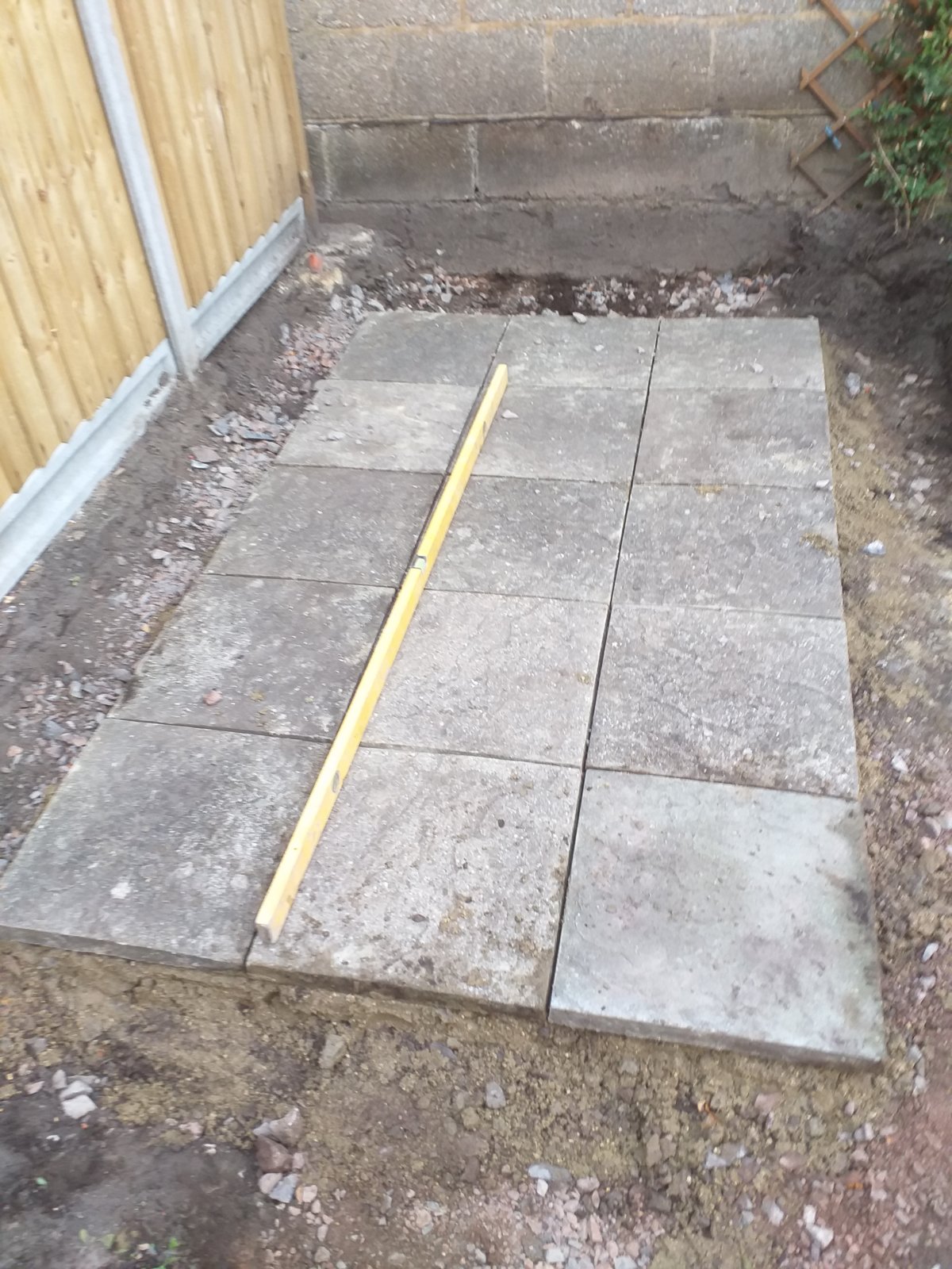

My friend borrowed a wakerplate and we hammered down the stones first. Then on top mixed the cement . At the front to keep the slabs at the same height as the others I had to put two inches of mortar which I felt was too thick so mixed in some of stones in cement or underneath. Used the level as a straight edge to see if it touched all long rhe slabs and none not touching. Didn't care if not level. Was this done right?
Needs 2” minimum. Would help to have laid an edge stone first or it risks movement.
I take it that's two inches of ballast? As pure mortar wouldn't be strong enough alone to stop slabs sinking , would it.
By edging do you mean that stuff u see on the sides of pavements?

Cant see an edging stone on yours? Looks good though. Would you recommend putting more cement on mine around edges for more support? Currently they're hanging a bit over edge
It's only having a shed on it though

How long you leave the concrete yo go off before putting mortar on?
Couple of days will do in good weather.
You can see my edge, granite sets on this pic of frontage.
Me and my friend will put shed on the slabs tomorrow. That's three days . Will they be ok to stand on then?
Is it the key to have a straight edge run flat on the slabs but sloping slightly in one direction for drainage?
Yes level one direction slight fall on the other , should be ok for a shed base , level the shed though .

How do you get the gaps made? Do you use spacers similar to tiling?
I assume you always dig down for hardcore and concrete to be below the surface
The gaps are judged by eye as the slabs dimensions are not uniform and vary in size.

Too narrow and difficult to grout, too wide and risks breaking up.
15mm?
