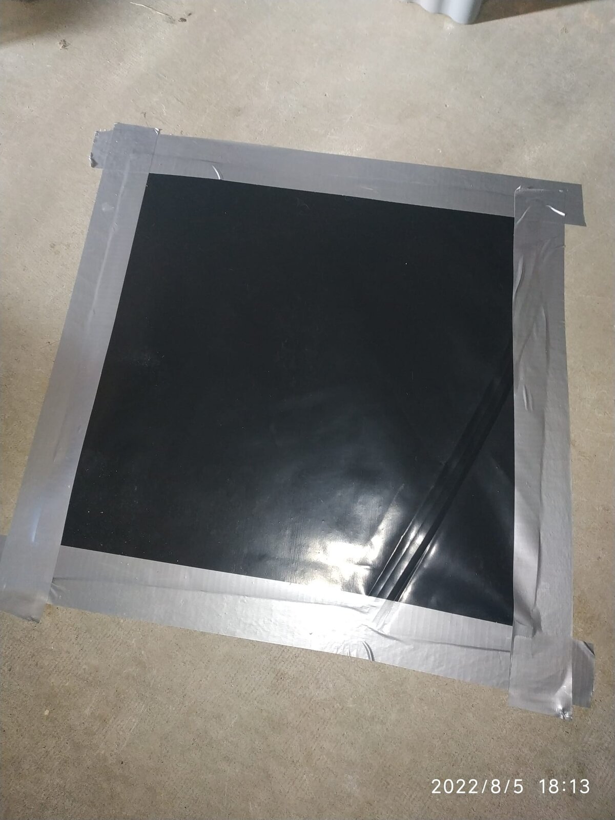

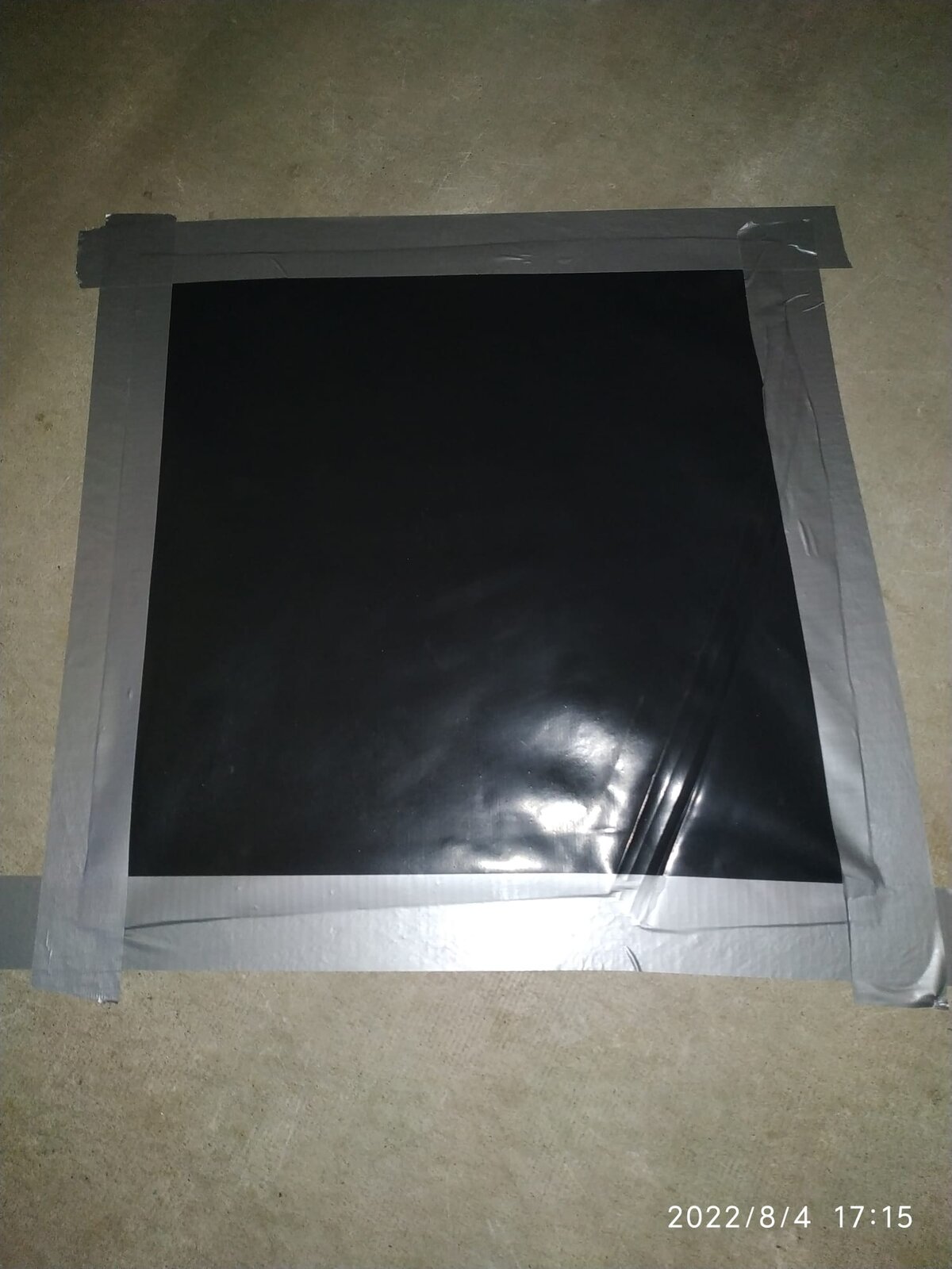

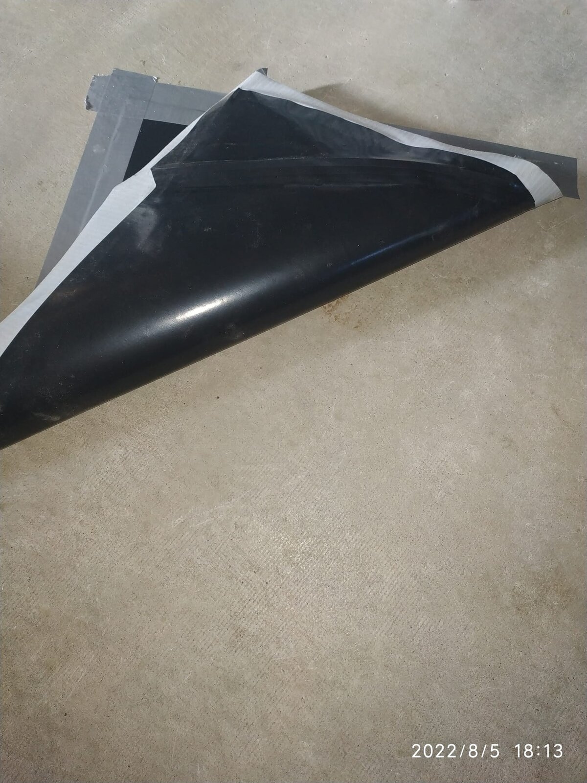

If you are curious, cut a square of polythene, tape it flat to the floor, leave for a day. If when you lift it there's a damp patch then good odds there's no DPM under the slab.

Ok, I commenced the test. After 24h will see if there is dump collected under this 1000 gauge membrane.

I forgot to share the results of my testing
It looks like there is no dump collecting underneath. It's dry as before.
Sorry to play devil's advocate here, but we are in the middle of an exceptionally dry period when river levels even up here in the Pennines (a notably wet and windy part of the world) are very low. As is the water table. So surely all your test confirms is that the slab is dry now, not necessarilly that it still will be after a wet November when the water table is near to the surface
