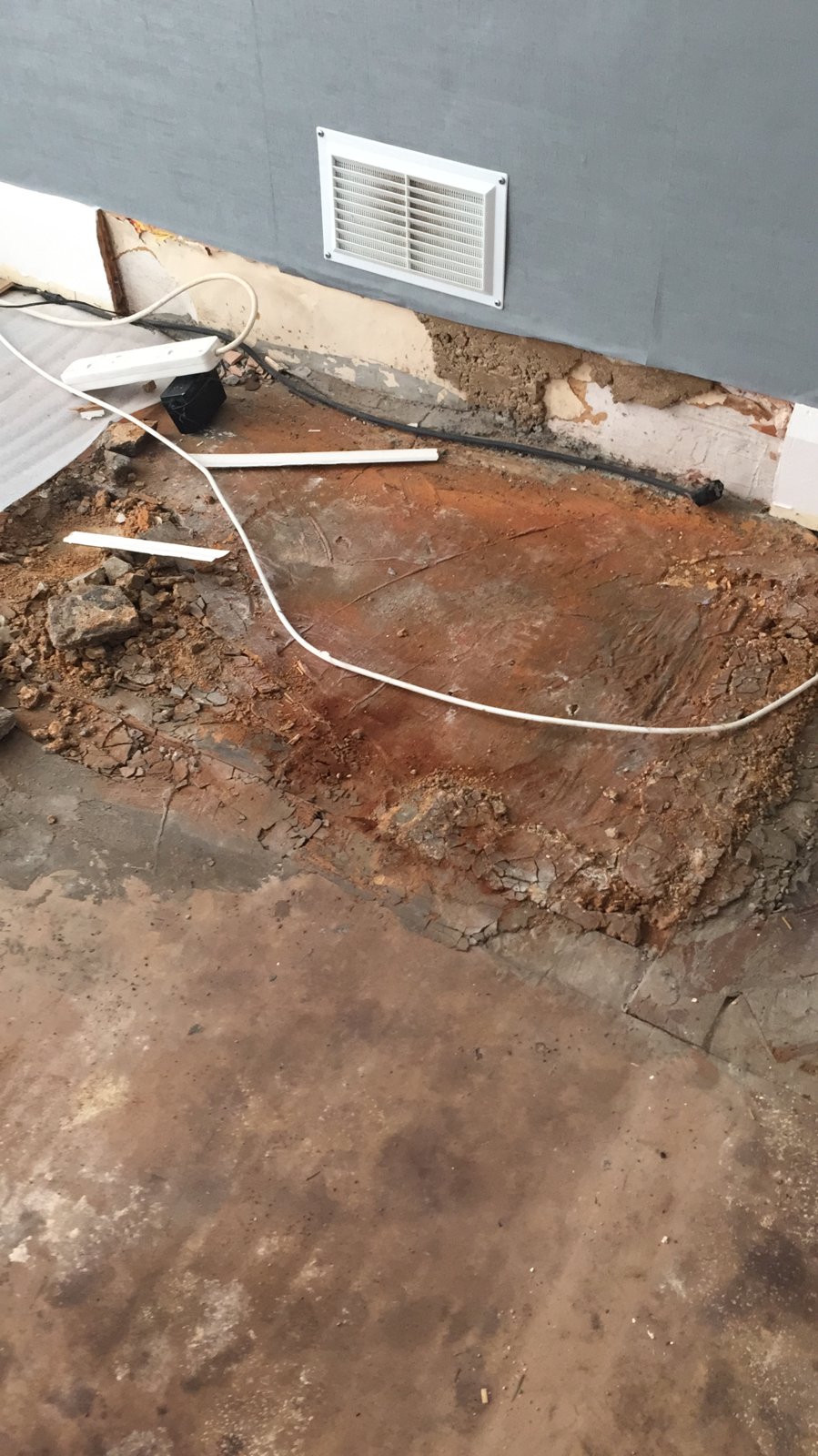

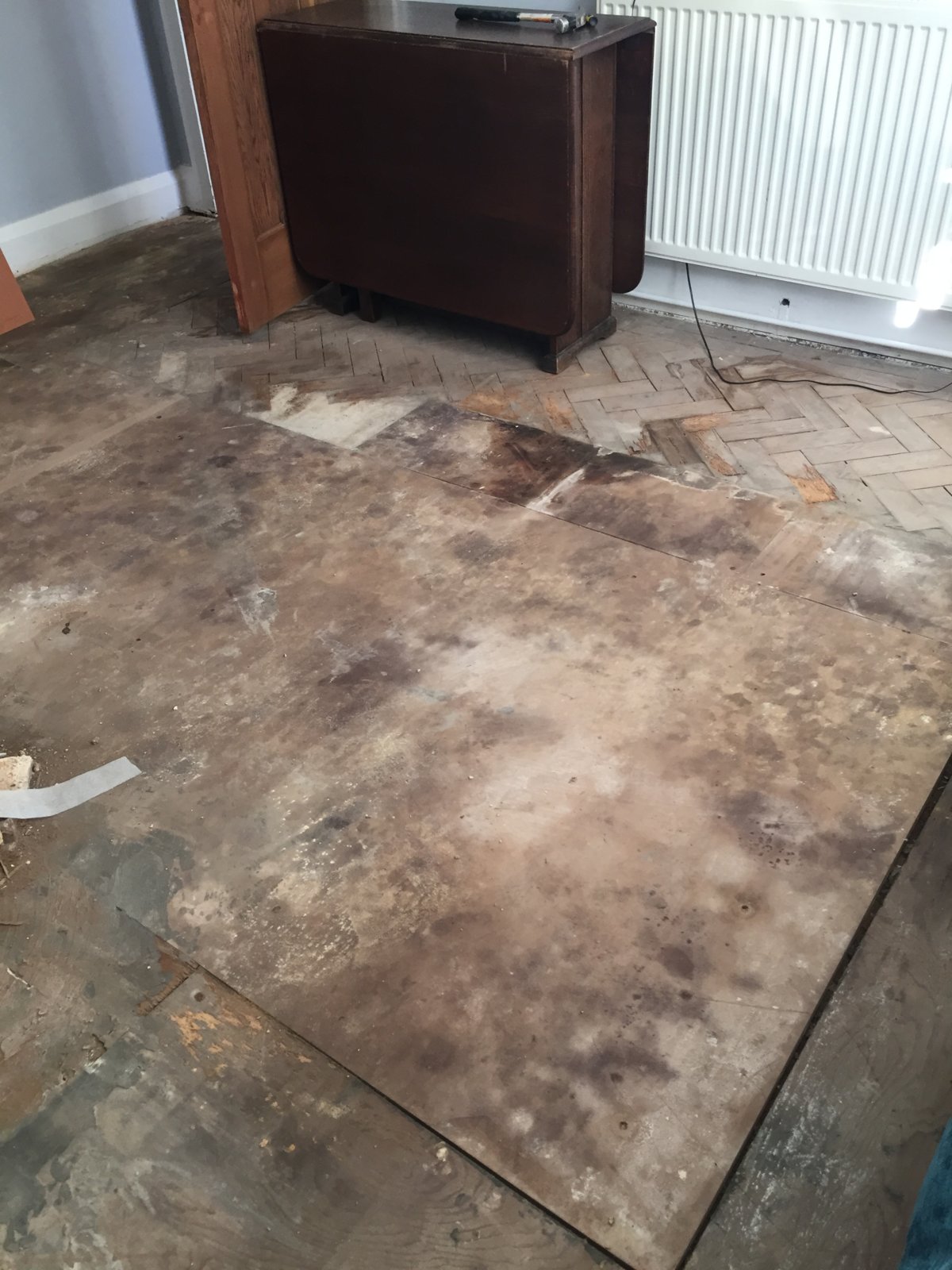

Could I have some advice please as my plans have gone a bit awry.
A section of laminate flooring in a downstairs room appeared to have lifted and unclicked itself. I took it all up yesterday to investigate what was going on. I thought it was possibly due to damp and a rubbish DPM.
When I moved in 4 yrs ago I was told by the owners it was a concrete floor. However having lifted the laminate it’s actually a mix of parquet floor (surface damp and powdery) and thick plywood. There’s also a small area of crumbled concrete where the original hearth must have been.
I was originally just going to put a DOM/underlay combo down but now I’m not sure as the majority of the floor is wooden. The main damp area is wooden and about 1 sq m in a 15 sq m room. I’d be grateful for any advice
why not post photos, eesp of the hearth area?
the laminate has tented due to moisture pressure and/or lack of room to expand.
most probably from moisture coming up from below the hearth surface.
but if the sub-floor is a mix of ply and parquet then it seems to have been originally laid wrong.
does the concrete floor itself have a DPM?

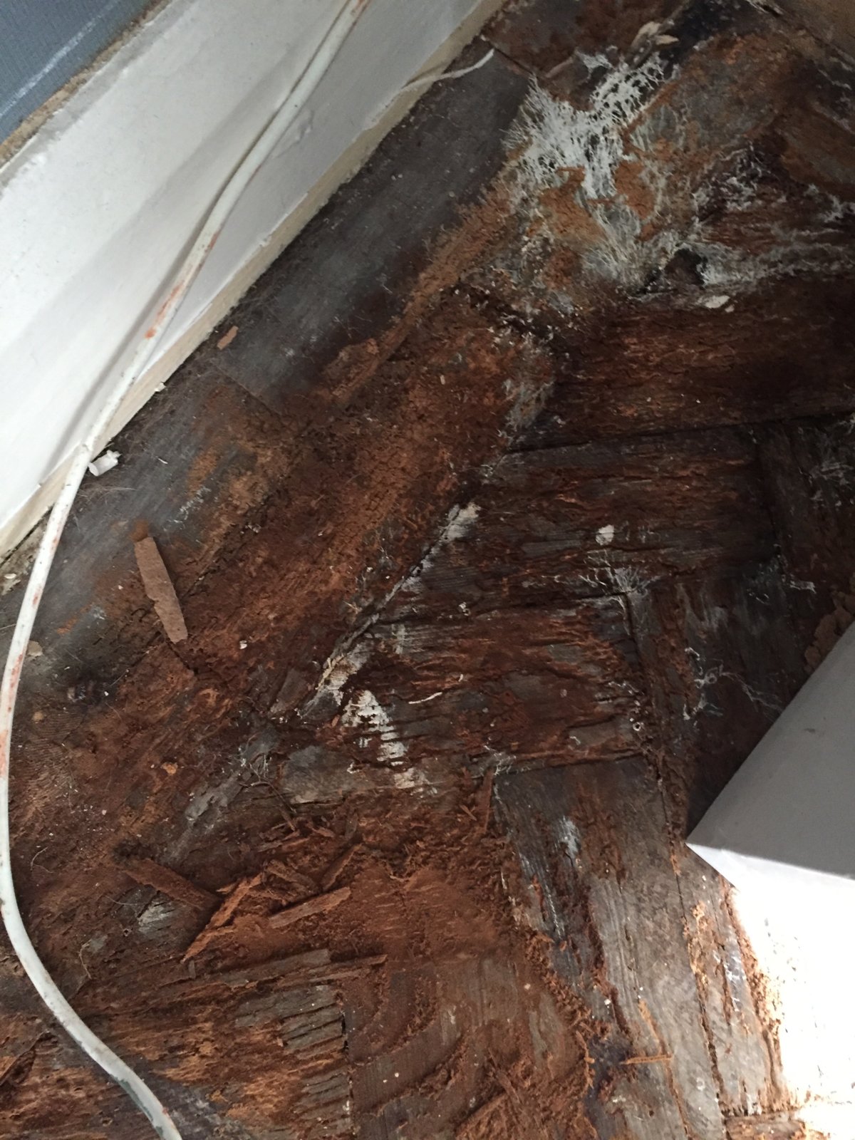

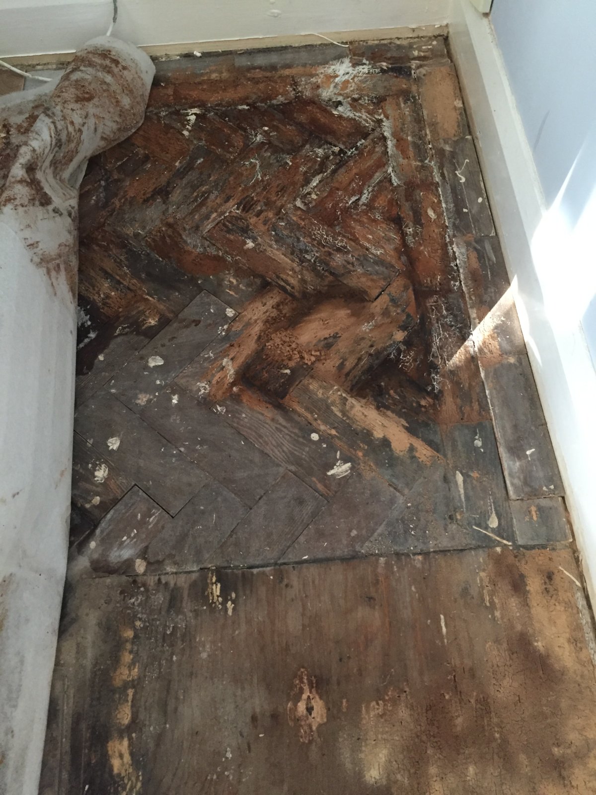

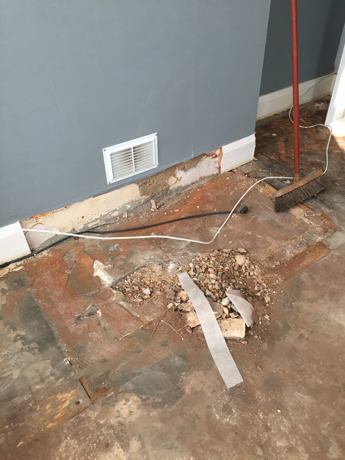

Photo’s for your viewing pleasure....

Rip all the timber out, add dpm and sheet ply if you intend to lay laminate again?
thanks for the pics.
is this room a total area concrete floor or is it a mixed solid and suspended floor?
are the surrounding rooms solid or suspended?
you will have to lift an remove all floor coverings and underlayment.
the hearth will need digging out to 300mm min deep.
ther's indications of what maybe damp on the chimney breast face - strip the wallpaper from the chimney breast to see if its concealing damp/salts etc?
why not remove the large vent screen an shine a light inside the circular vent looking for soot/rubble/vegetation?
any signs of damp on the skirtings you've removed?
you've got what looks like true dry rot - with possibility its a weird kind of wet rot?
when youvedone whats suggested then post more pics please
