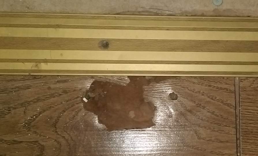

1. I believe the laminate was put down in this house when it was built in 1994 so, in the hall at least, it goes under the skirting. At some point, the previous owner has managed somehow to take two sizable (like 3”) chunks out of it.
I don’t see any easy way of replacing the damaged sections without taking the skirting off, which I don't want to do… any ideas anybody? I might even settle for filler, if I could get anything suitable which would approximately match the colour…

Forgot to post the pics of the damage too {D'Ohhh emoticon}

You could cut the laminate in situ with a multi tool ( or Stanley knife , repeated cuts)along the middle which would allow you to remove the edge board from under the skirting . Replacing is more difficult though you could just leave short and cover gap with more scotia trim .
I have put boards under fixed skirting but requires ripping the new plank to just a few mm over width and removing the bottom lip of the laminate . Then the board can be placed under the skirting and pulled back to meet existing with a drop of wood adhesive run along joint first . This is enough to keep joint secure and being at the edge gets very little if any foot traffic.
