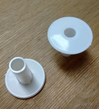

Given the sharp bend the cable will make at the bottom of the tube I would fit one of these ( or similar ) to protect the cable from abrading on the edge of the metal tube.

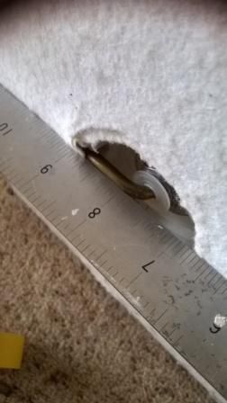

That looks a bit tight to bend 3 core round and through the base tube, do you possess any tools to trim a bit more of the threaded bar , I would guess it was flat 2 core cable previously.
I would opt for the metal holder as its stronger

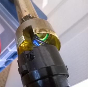

I was able to 'shorten' the threaded tube by adjusting the nuts' positions on the threaded tube:
Then theres extra tube at the top which is swallowed by the internal thread of the "shell case" at the very top:
Its solid now, no wobbles.

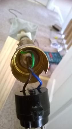

My current concern, having realized to use metal lampholder (thanks for advice folks (y) ) is how the cable is clamped, is there a bit missing? :
@ Bernardgreen: the tube is continuous. What are the plastic fittings called you posted pic of please.
