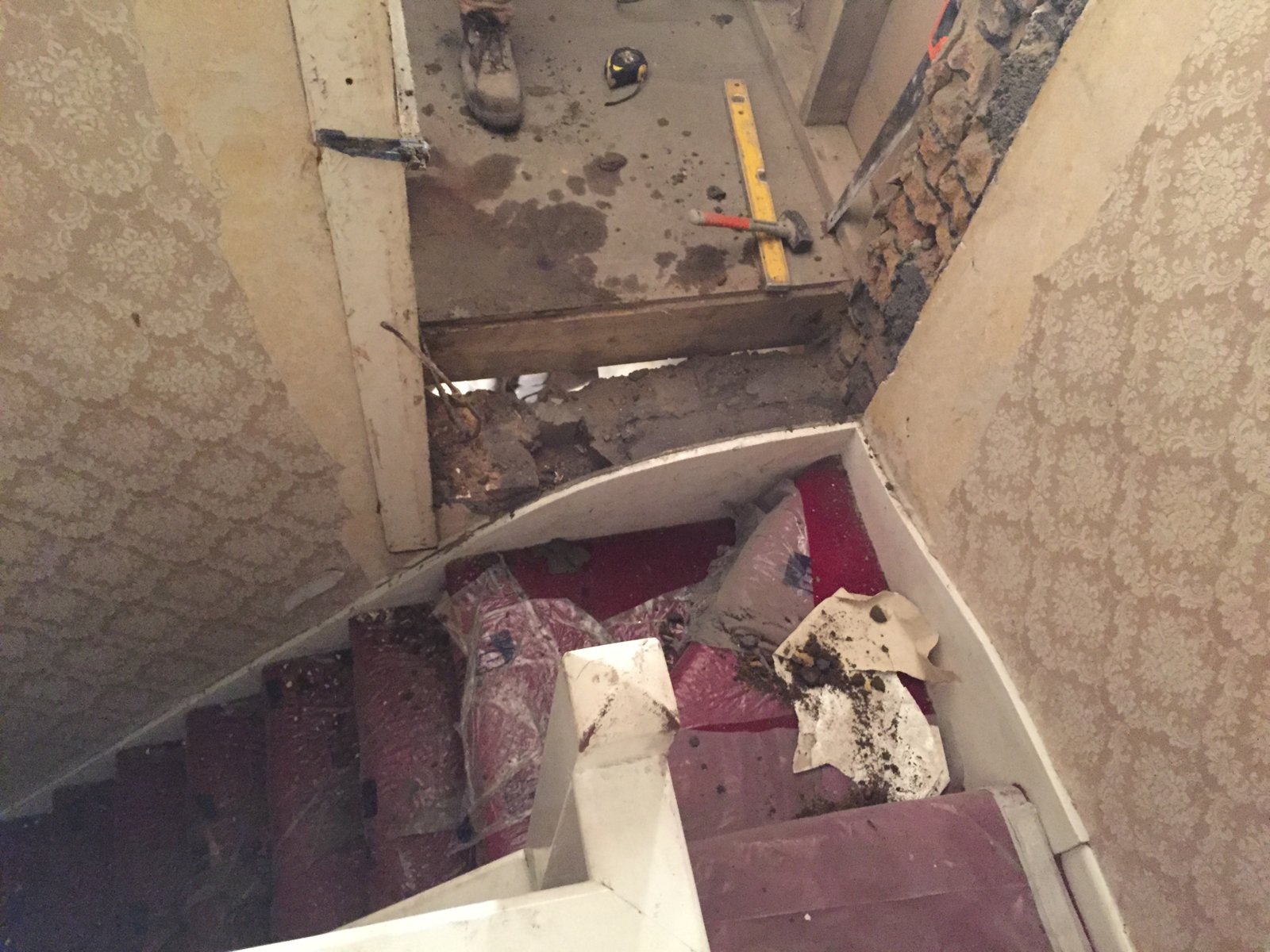

The tapered treads are presumably existing but only turning to the right as you go up on to the existing landing.
The drawing shows access to the new extension (hatched ) ,presumably through a new opening in existing wall, turning left off the tapered tread . You can't turn to the right and the left off the same winder as I said previously .Maybe Chaji can mention this to the architect and get back to us.

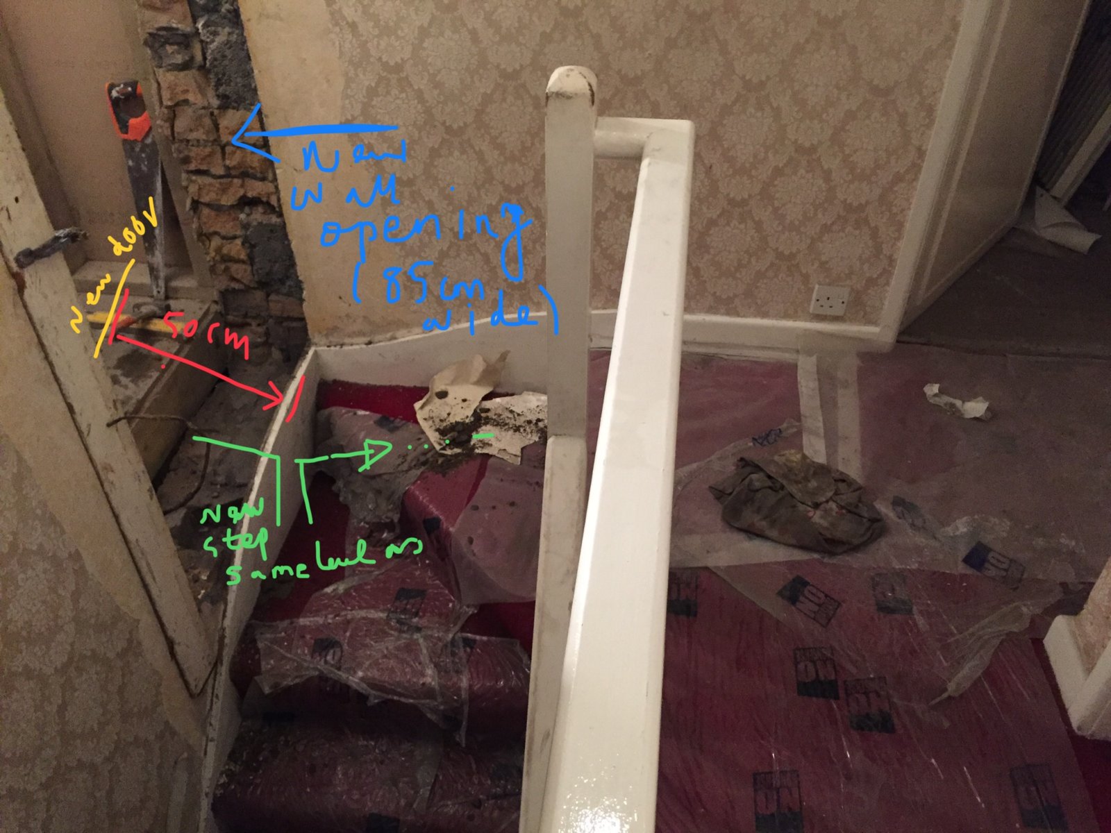

I’ve attached the actual picture, I don't claim to understand everything you guys said.
The area on the left is new extension where you can see the opening. There will be one more step pretty much on the top of the wall that would be same level as the triangle step.
(After conversation with the builders) I’m thinking to leave about 50cm from the new opening and then put the door.(i.e there will be 50cm gap between the new door and the lower triangle step)
What do you guys think?
Have you got the room to pull the staircase forward to create a flat landing?
In my opinion it would make your extension feel more part of the house rather than an add on.
I'm no expert on building regs but if you have young children then having the layout like that all looks a bit dangerous to me.
