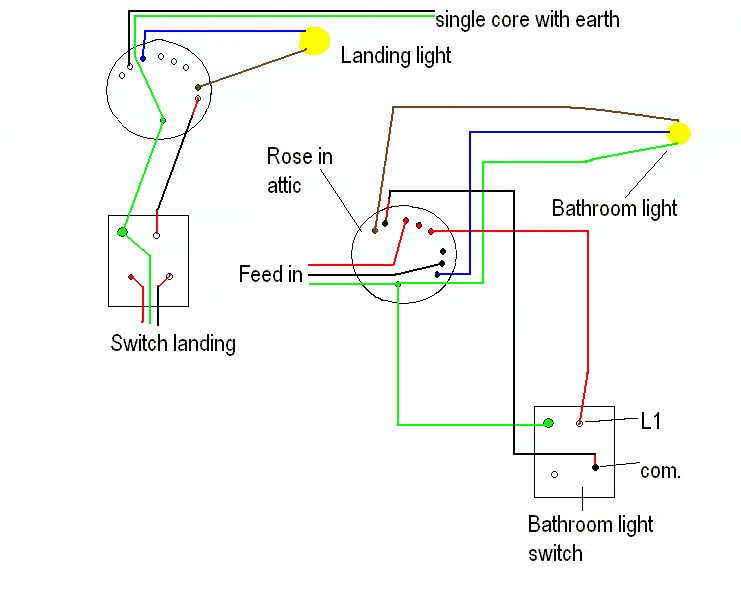

Hi,
Can anyone help me with a 2 way switched landing light, I have a sketch showing the bathroom light and switch (how do I attach it to this type of correspondence) which I have totally replaced and works. The light on the landing does not, there is a single core with earth which becomes live when the landing light switch is operated. Where can I terminate this live cable? The rose shown is in the attic for the bathroom.
Regards

I have re-looked at the problem and put new every thing in so that I knew where all the wires where as it seems to have been a botch job which I was using. I have sent my picture to admin as I have no website. Hopefully the picture will explain a lot of the problem. Bathroom light works correctly now. But the single core cable is still the problem, where do I terminate it so that the landing light will work. At present when the landing light is switched on the single core cable becomes live.
Regards
Will

Theis cable was connected to the bathrom light there is nothing else that it can attach to in thearea.
I do not but it had to go some where on the connection arrangement that was there, if the picture has not arrived yet is there a way that I can get it to you.
Will
The bathroom light is the last in the series of lights, if I link this into the feed in from the previous would this work?
Bathroom light / landing light picture is now available, all wires terminated in cable strip ie 3 connectors. where do I terminate the landing light in the new ceiling rose?
