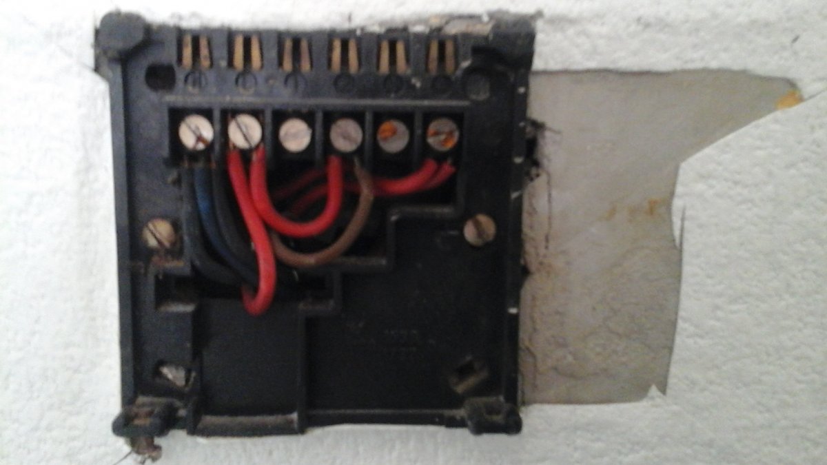

Hi, please help, i have a L&g mechanical clock programmer, can this be upgraded without changing the backplate?
Thanks for the help
