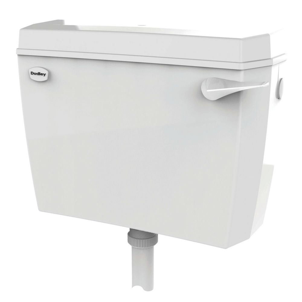

Order online at Screwfix.com. 9Ltr side-inlet cistern with built-in internal overflow for use in high and low level installations. Suitable for light to medium duty, domestic and commercial applications. FREE next day delivery available, free collection in 1 minute.
Order online at Screwfix.com. Dual-flush cistern with built in internal overflow for use in high and low level installations. Suitable for light and medium duty, domestic and commercial applications. FREE next day delivery available, free collection in 1 minute.
