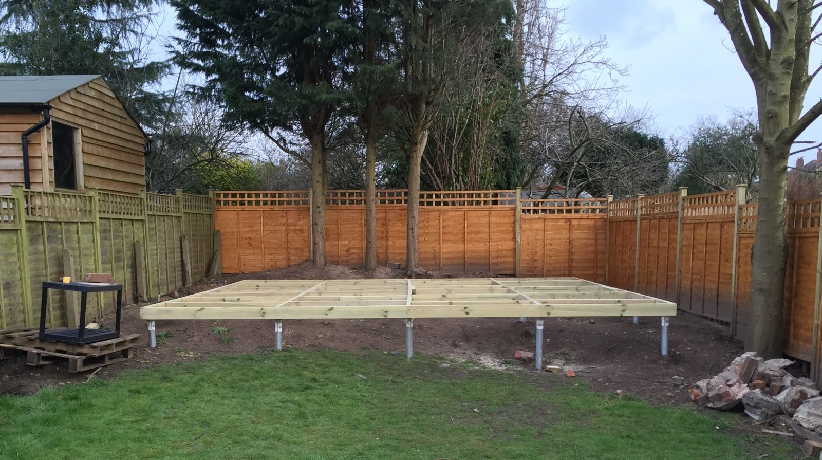

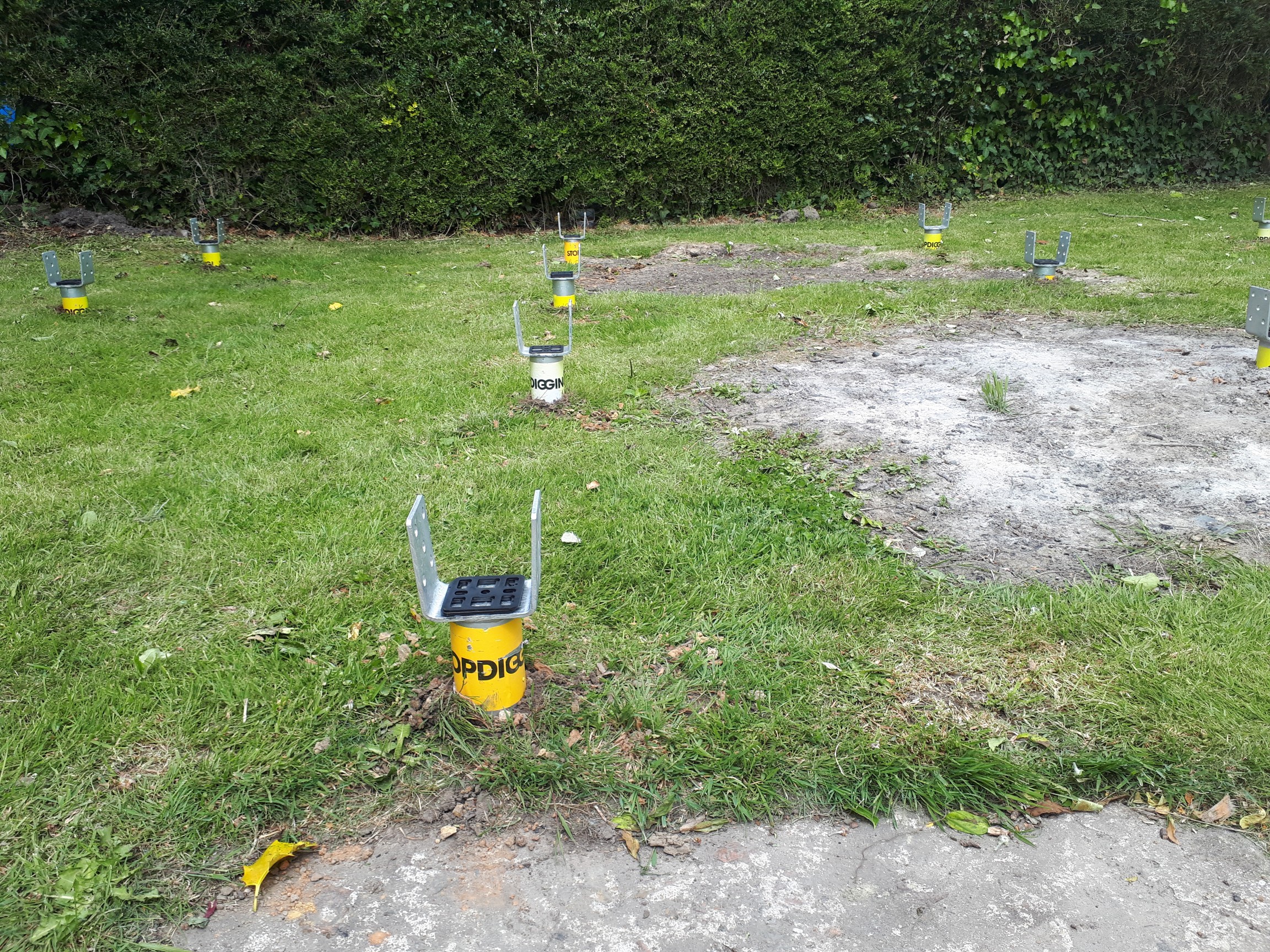

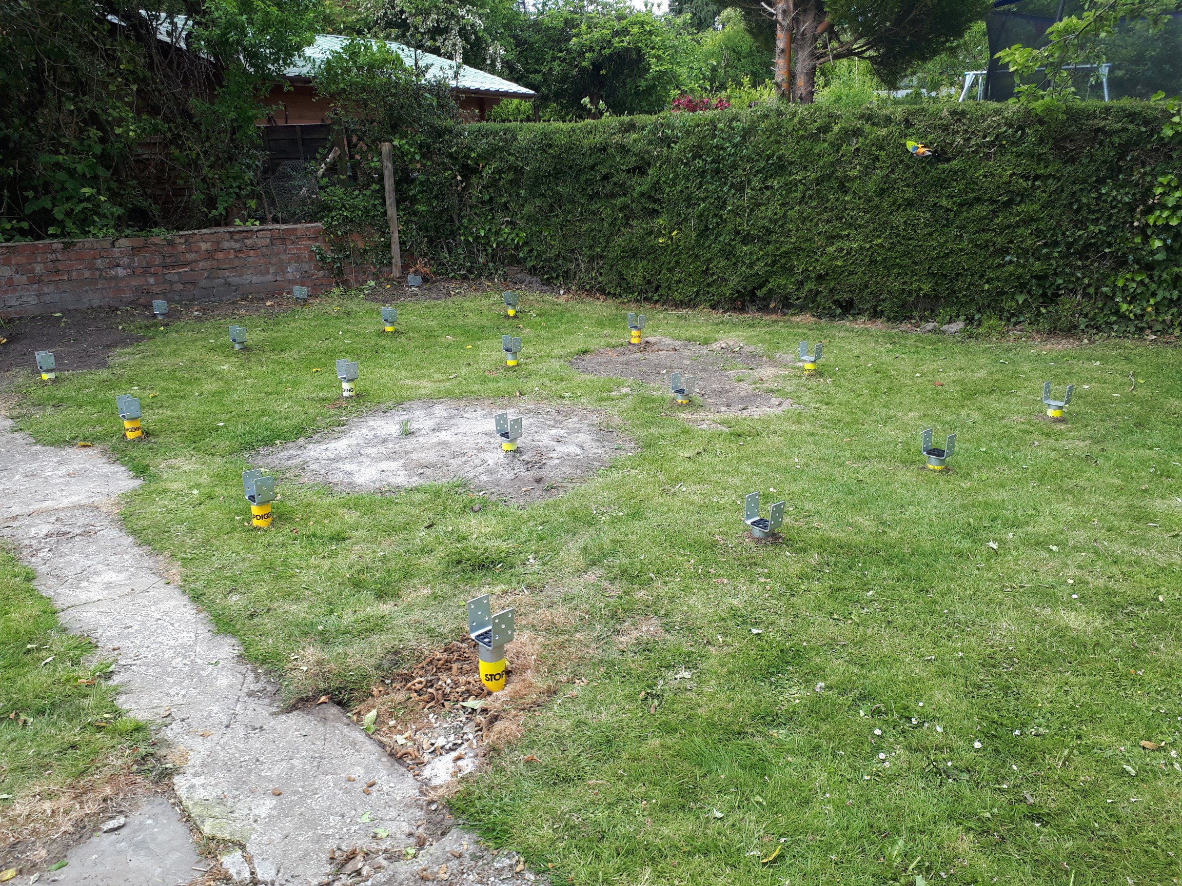

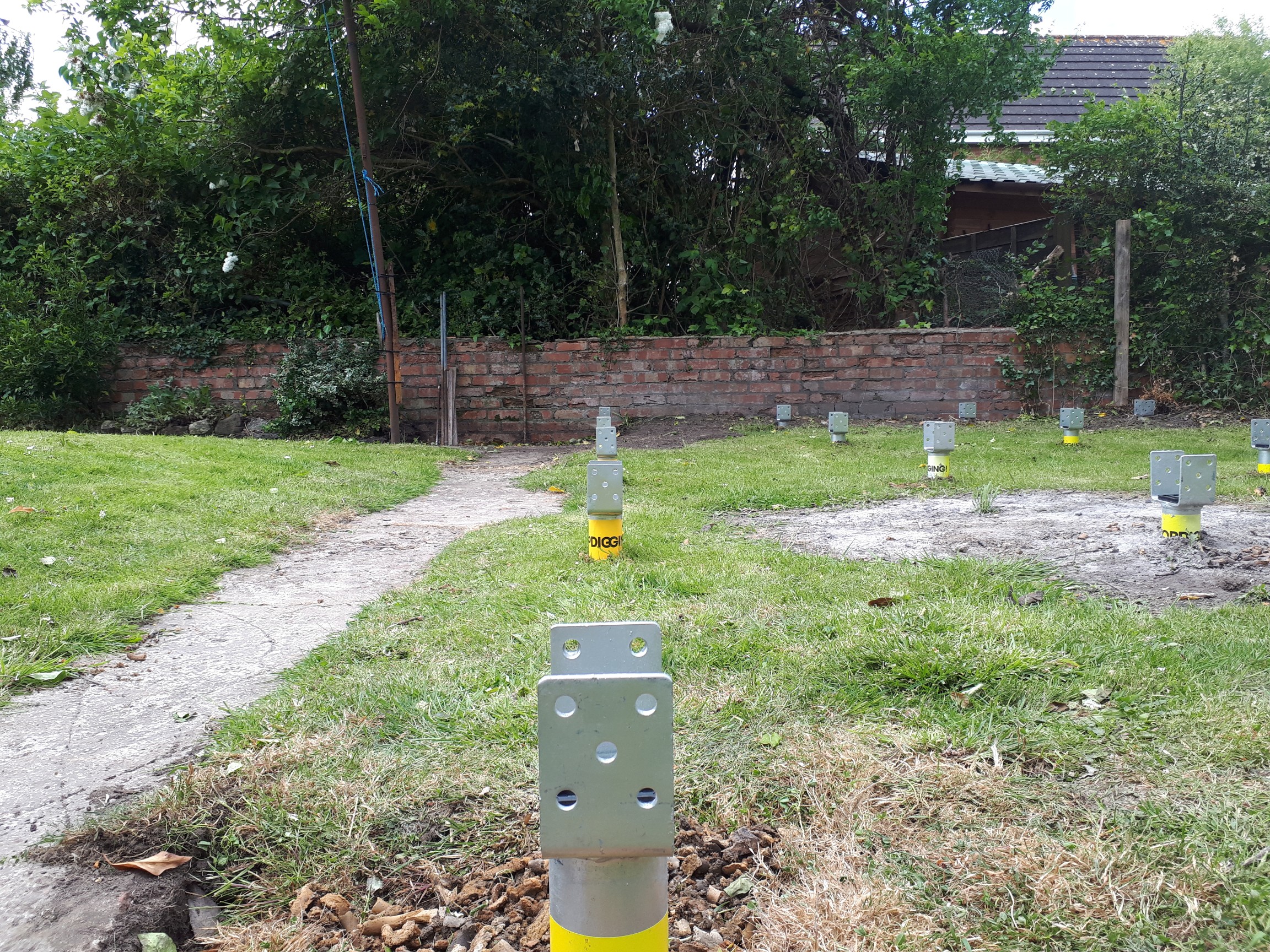

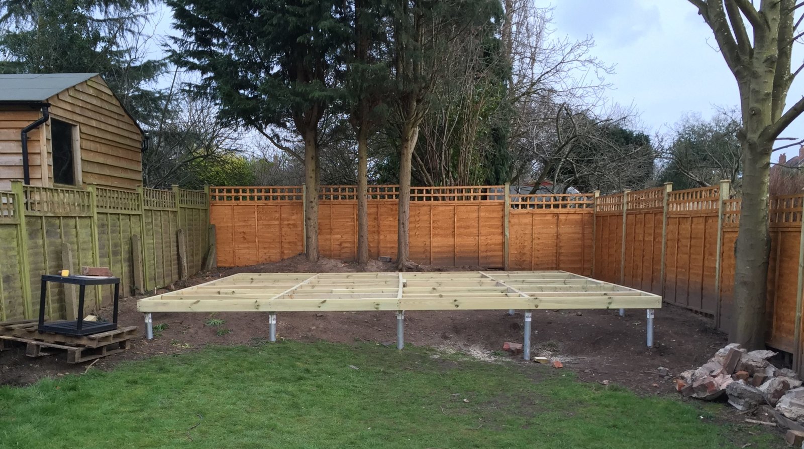

Went with ground-screws in the end, there's a couple of companies that seem to offer an installation service (I was unsure I'd get them in straight), found a local-ish one who was willing to travel.
Things had dried out a bit by installation time, but hopefully it'll be just as stable when wet - 20 screws, each one being 4ft long. Reckon that'll do..
more to follow in it's own thread at some point.
p.s. Very happy with the screws, top service by the fella that put them in, had it done in a morning, and each one was spot on location-wise. the neighbours and other trades have seen them and are impressed too.
