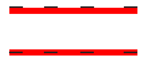

Hi, when using a laser level where do you put the pencil mark?
  • The edge of the laser line?
  • The middle of the laser line?
  • Other?
The middle. Laser lines aren't perfect, and you will see a widening over a long distance. The centre will always be the middle of the original light projection.
