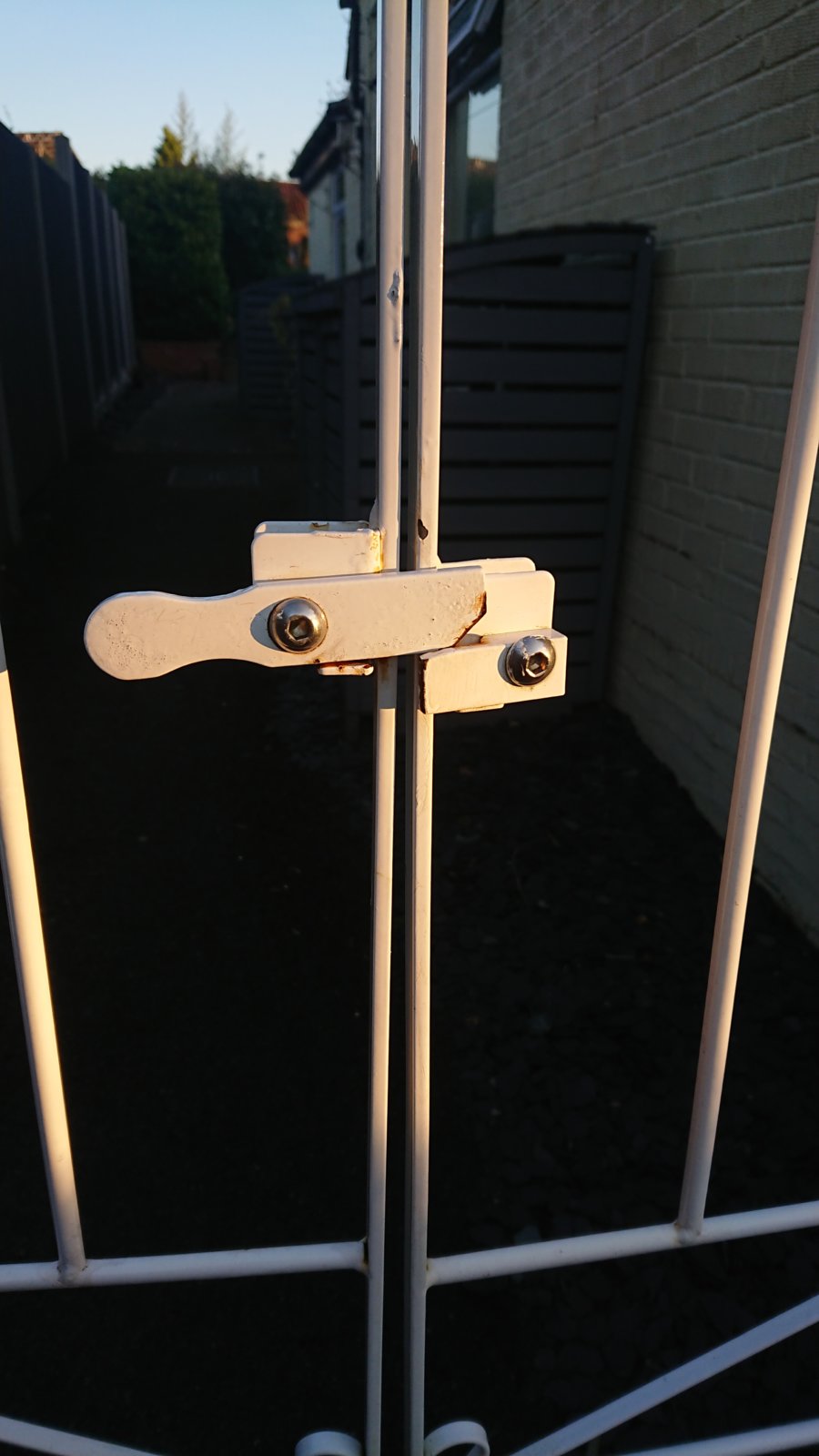

My toddler can now force this gate open by giving it a good shove - the fixed leaf is not held at the top so the gate flexes and the catch pops. Can you recommend a better latch which positively locks or would otherwise hold the gate?
As you can see from the picture I have one mounting hole per leaf, but I can drill more if necessary. Welding isn't an option. I only need child resistance, not security against intruders. The gate is used regularly by delivery drivers.
Is the bolt/rivet on the right-hand bit of the latch removable? If so you could bolt on a small metal extension.
If not, you could drill and tap that bit then add the extension.
What about one of these?
or a carabinier?
Or, drill through the flats of each gate and put a bolt through.

Yes, it is an Allen head bolt and removable. What do you mean by extension?

Carabiner is one potential option, thanks. If I drill through the flats, where do I mount the bolt? Assuming you mean a tower bolt.
Just put the bolt through the two holes (one hole in each bar) you could put a nut on the bolt just to be sure.
I meant an ordinary everyday bolt 6mm or 8mm by 40mm long would do.
