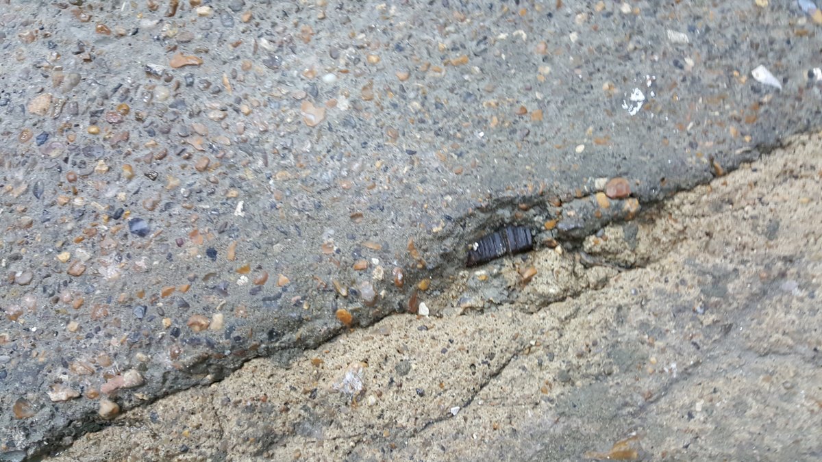

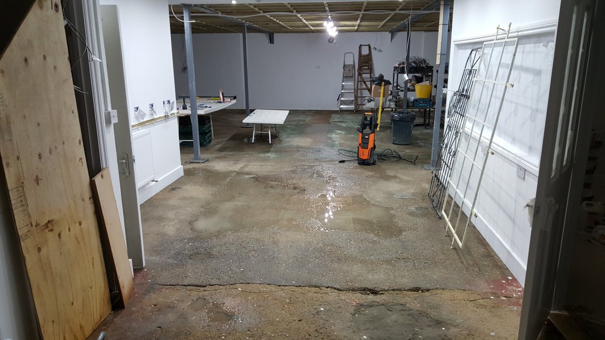

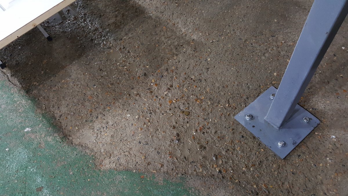

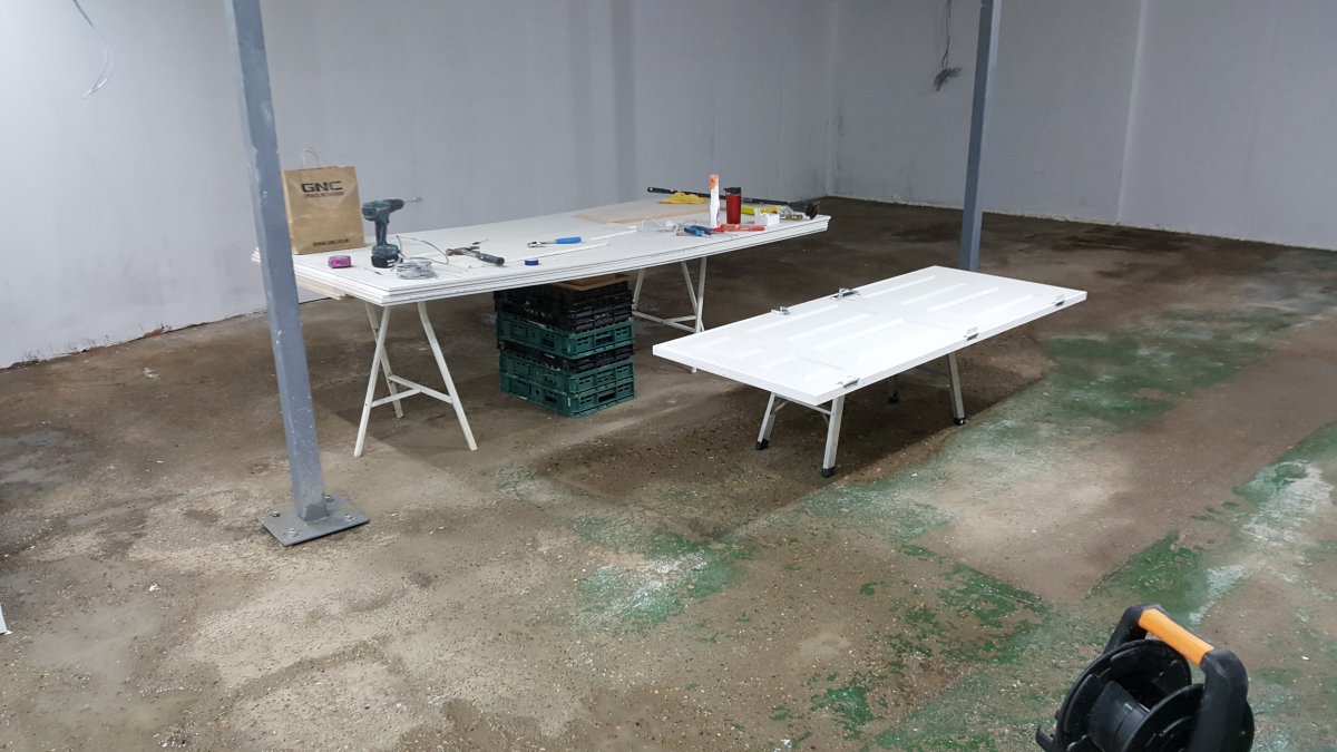

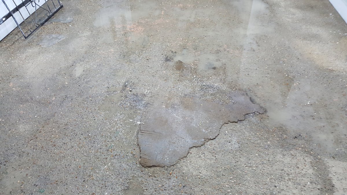

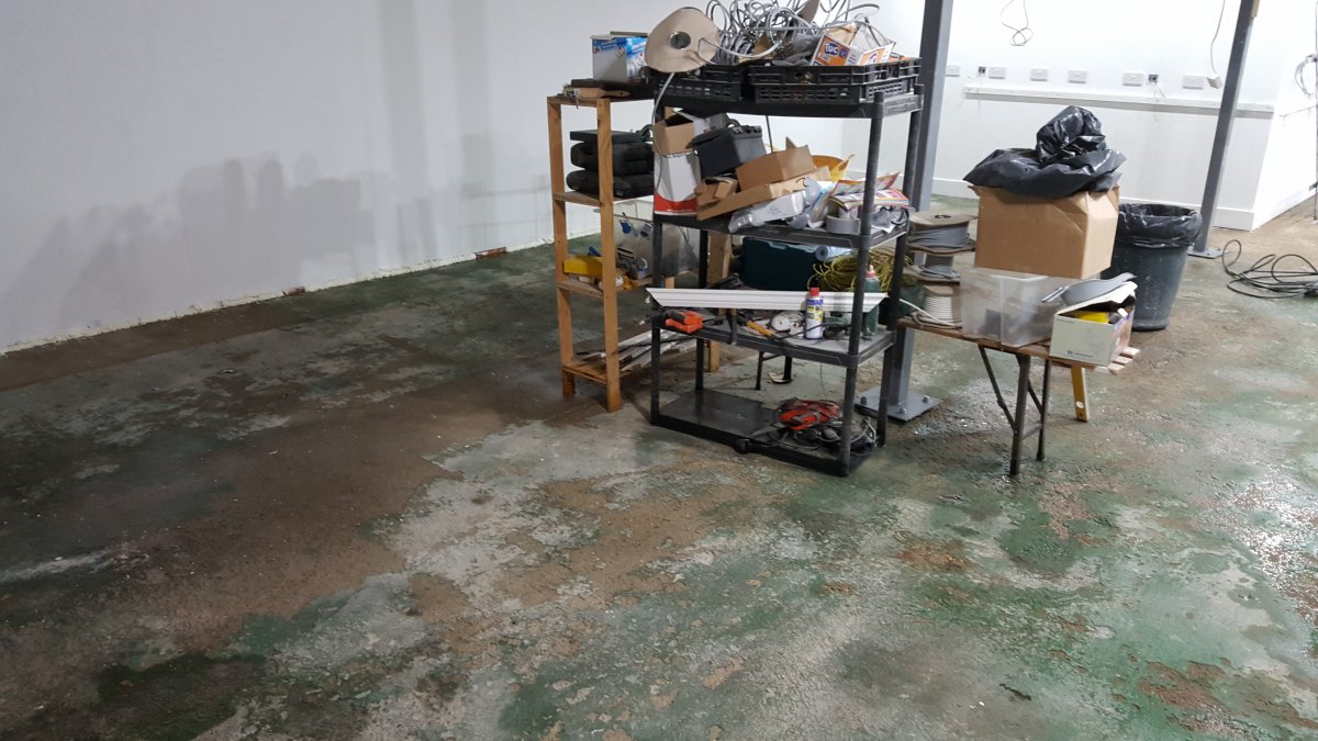

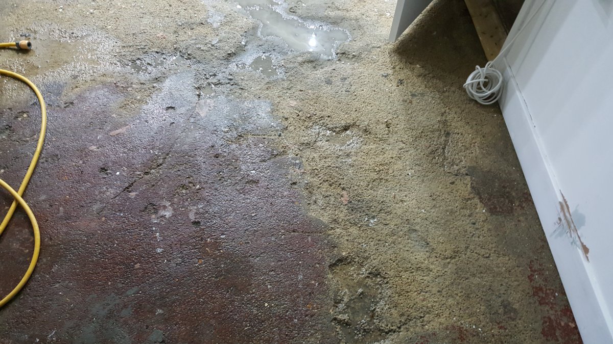

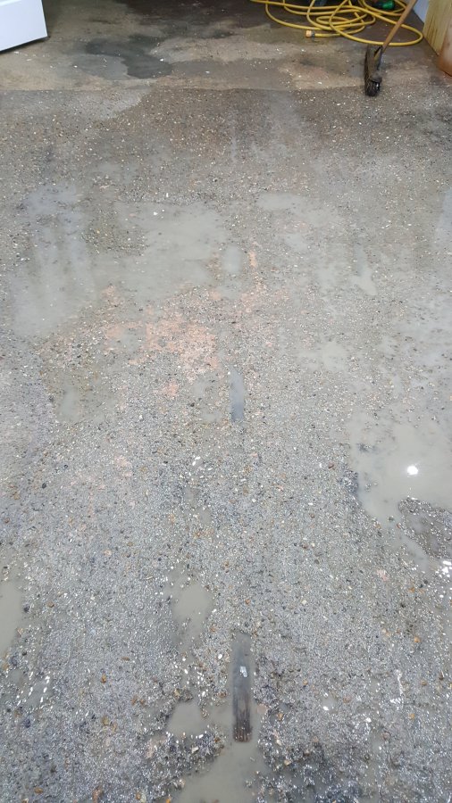

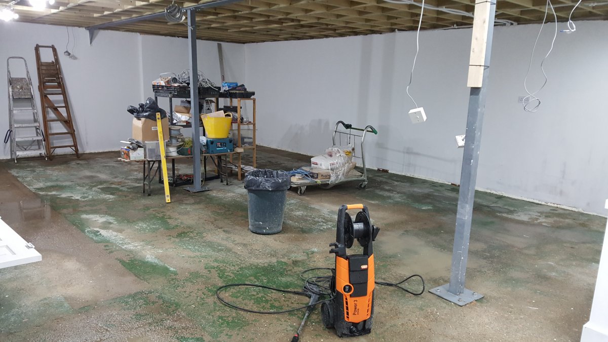

Really confused after a full power wash of the floor. Spend good 2 hrs pressure washing and the concrete does not look too strong, with a bit of pressure the top layer seems to chip away quite easily and also the water seems to disappear (soaked in I guess), I was expecting it to settle on top and having to broom it off. Well I did had to use the broom but only on the puddles.
Attached are some pictures...

Will a SLC do or does this needs a new layer of (65-100mm) concrete screed?
For me it needs a grind 1st to take off old paint and loose gear
Then a couple of coats of primer.
Does the floor have a DPM
