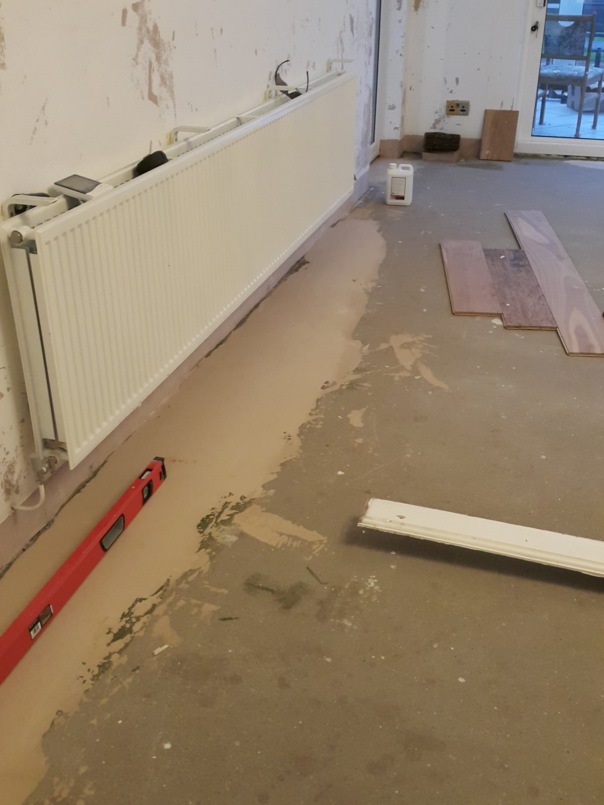

Hi I'm in the process of levelling and it's my first time so I wasn't sure how much to buy. I figured I'd do it in layers and build up rather than go too far.
I need to build up another 5mm in places. Should I prime this or just lay the new levelling compound over the already set levelling compound? Its setcrete rapidset 30.
Instructions don't say anything specific just to use primer on subfloor before laying. I guess the set levelling compound is now subfloor so I'd need to prime it?
The same principle still applies, as you don't want the moisture sucked out too quickly, so it still needs to be apllied.
