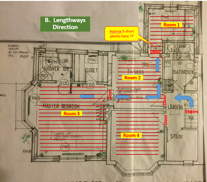

Your advice please on laying a laminate floor over the whole of my upstairs.

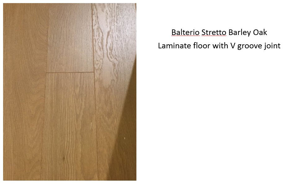

It is Baltiero Stretto, with a pronounced V groove click joint and therefore important to lay it running in the right direction so that the planking lays relevant to the whole upstairs floor. I prefer to feel that I am mostly walking down a very prominent planking, rather than across it.
No problems laying it but from doing just one room #1, a small L shaped room, I have decided to do the whole upstairs in it.

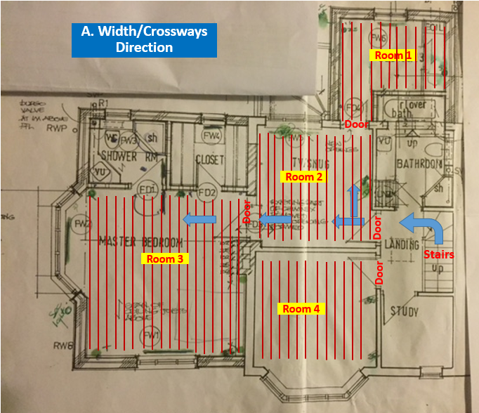

#1 on my photos and plan below. It lends itself to being laid widthways, see floorplan A.
I have started that room and like the flooring so much that I now will get more of it and am considering getting more and laying it on the whole upstairs. The old laminate in those rooms does not show the joint, but because of the vey noticeable V groove joints in this new one, I want to lay it the right way round for the whole combined area.
So I am now questioning if it should really be laid as shown in 'B lengthways direction' ?
B Lengthways.

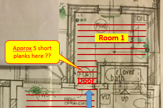

There are about 5 short lengths in the doorway of room-1 that may make it look odd! However, laid that way Lengthways, it will look right for most of the upstairs, flow well from stairs, landing, through room 2 and into room 3. It will present lengthways planks seen when coming up the stairs and seeing it from the landing - see blue arrows showing main traffic areas.
I feel that looks best but your views and advice please, before I do a whole house the wrong way.

You don't mention what will be under the laminate floor. I have T&G floorboards, and was told by a professional floor layer (if that's the right term) that the laminate should be laid perpendicular (90 degrees) to the existing floor boards, to prevent movement / separation of the laminate joints with the boards below. So, that made the decision for me.
Thanks stem,
I also understood the same regarding the underfloor and the laminate being 90 deg to it.
All of my floor is 22mm chipboard 8' x 2'. Only the Room #2 shown on my plan is the old pine T&G. But between the underfloor and the laminate is the green fibre underlay board, that should stop any movement. The laminate is also a quite thick one so should hopefully help in keeping it all robust.
The bit in my plan that I feel is visually a bit questionable is the doorway to room #1. There are about 5 short planks just in the doorway, but that is the only thing I query about laying it in that direction - it could look a little 'bitty'.
I wouldn't be asking this if the laminate was normal discreet joints, but these V groove joints accentuate the lines, flow and layout, so I feel it needs to be right.

Thanks, I have tried to show the rooms in photos as best I can. The old flooring is still in place and some of the new laminate has been overlaid or already down, as shown in photo of room #1 which has been part laid.
That was the best direction for that room but will clash with the lengthwise approach which I feel works best for the rest of the house. I should have really startd in room 2 and worked outwards, but due to refurb of the house it hasn't worked out that way.
I think that your link to Quickstep, thanks, has largely confirmed what I prefer, the lengthwise approach plan B in my photos.
I would like to run through the doorways and keep the planks aligned, with a threshold strip across it, but alignment of the board joints - don't know how practical that is to do?

The only hesitation I have is the doorway area in Room #1.
That is the room I am starting with because the others won't be ready for 6 months.
I just want to know if those 5 or so short planks will look odd, which is a consequence of the rest of the upstairs rooms having laminate laid in that lengthways direction.

not a pro but i’d go with option B as it will cope with any level changes better between rooms.

Thanks, yes that is my preferred option as even with thresholds at each door it is the longest full run of boarding going lengthwise.
The few short bits in the doorway of Room #1 will probably blend in with the overall scheme.

I’d go B mate
Won’t be a problem with the short planks. I’d but a joint in a couple of them. So not full planks across.

Thanks, John. The longest run is 3.5m in all rooms apart from room #3 which is 4.2m. There is a 10mm gap and threshold strip at each doorway.

Thanks, a few words but you have obviously been through what I posted and understood it.
- I had thought likewise about breaking up the short planks with a midway joint in every other one, does that sound ok?
- Also, the perimeter gap, I would like to keep it to a minimum for as small a quadrant/scotia profile as possible. Is 10mm ok, otherwise it feels like a massive void and profile to suit.
