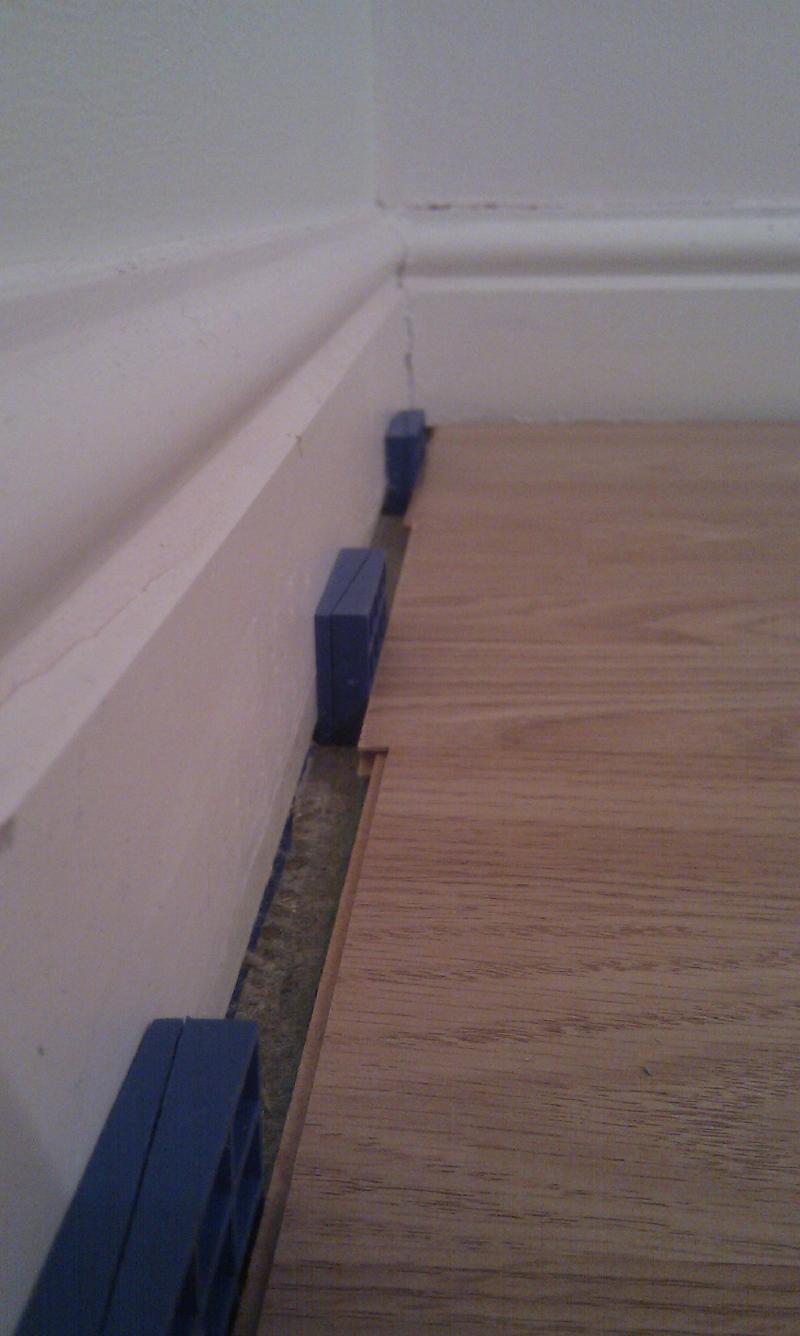

Hi,
I am laying laminate floor for the first time and I think that the walls in the room are not straight. In that case, should I let the laminate get away from the wall? Or should I continue with the 1cm expansion gap as shown in the picture below?
Any advice is appreciated. Many thanks,
Joao
Thanks, big-all. Does it mean that what is shown in the photo is correct?
Joao
Joao
yes as long as the step is less than 5mm and if your gap is 8-12mm tapering your room needs to be no more than around 4m
any greater than 5 mm taper the ends
