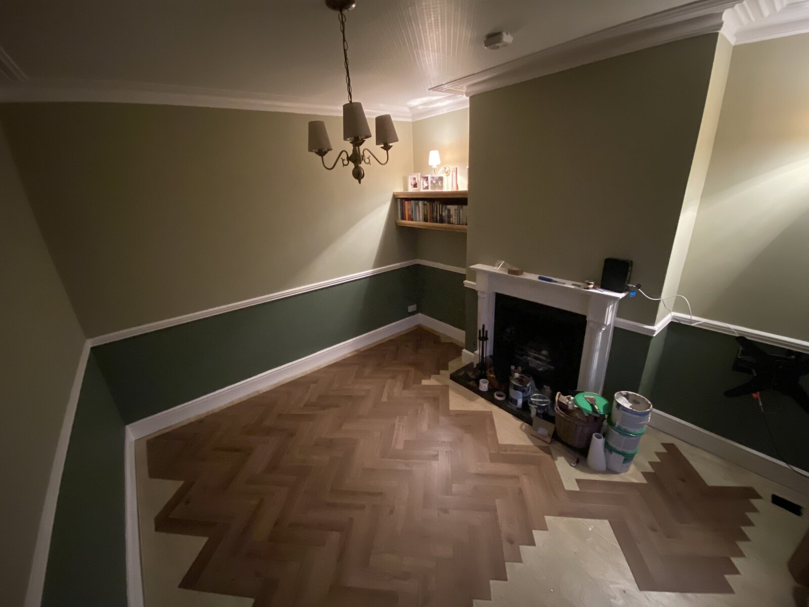

Wife didn’t like my suggestion of carpet and of course wants herringbone.
I decided to go for the glue down type as I think this will stand up better to fluid spillages from the children. I’ve screwed down 6mm ply and filled the gaps with jointing compound on the joints. Before I coat with primer, I have a few questions.
- I plan to mark up the room, starting with a cross to mark the centre and drawing a centre line down the middle.
- If this is correct, and I start laying from the centre, how do I then lay out from there? Is it possible to move around and across the flooring once it’s been glued down?
- Can you re-glue over glue which has already set? This is in case anything happens and I had to stop.

That’s really helpful, thanks. In that case I’m going to measure and draw a line set back from the fireplace hearth, do a dry run to check for straightness, mark up this ‘section’ to glue and then this will be my first run. Means I can work down the room from top to bottom, and no going over drying glue.
I’ve also decided I want a border around the edge, so will first mark this up around the room. Then when I lay the main body of the flooring, I can overlap this drawn border and cut off excess with a straight edge and blade (hopefully you can lift the tile up to snap and re-stick down?). Then when it’s all dry, I can come back and glue the edge tiles down which should just slot in.

So half the room is done. I drew the border first and it’s gone down nicely with no gaps. I laid dry first so could do some of the cuts around the edges (where it overlapped the marks for the border).
However. I think I applied too much adhesive (doubtful as I used the appropriate trowel) or it’s just not setting right. I’ve come down this morning and it’s still not fully dry and oozed out on one tile when I pressed hard enough. Walking over the rest of it cautiously seemed okay but a little “sticky” sounding.
I used Ultrabond VS90 which says a wait time of 0-10 mins. I waited 10 and put the tiles down on glue which was what I would describe as “wet”.
Have I ruined this job? I’m really concerned they won’t dry. Not sure if it’s a chemical reaction just taking longer if theres too much product, or an air reaction which can’t complete as the tiles have gone over too soon?

I’ve come home today and it’s noticeably firmer with no ‘sticky’ sound under pressure. I think it’s just taking longer to dry that expected — the tub says 24-48 hours before use, the data sheet online says 48-72 hours. The tub also says 0-10 min waiting time whereas the sheet says 10-20. Same product different advice….
I’ve done what’s on this pic so far. Just the main ‘field’. Will finish off after work tomorrow and then leave until Saturday. At that point I’ll go round and dry fit the border and cut tiles, then fix into place.
