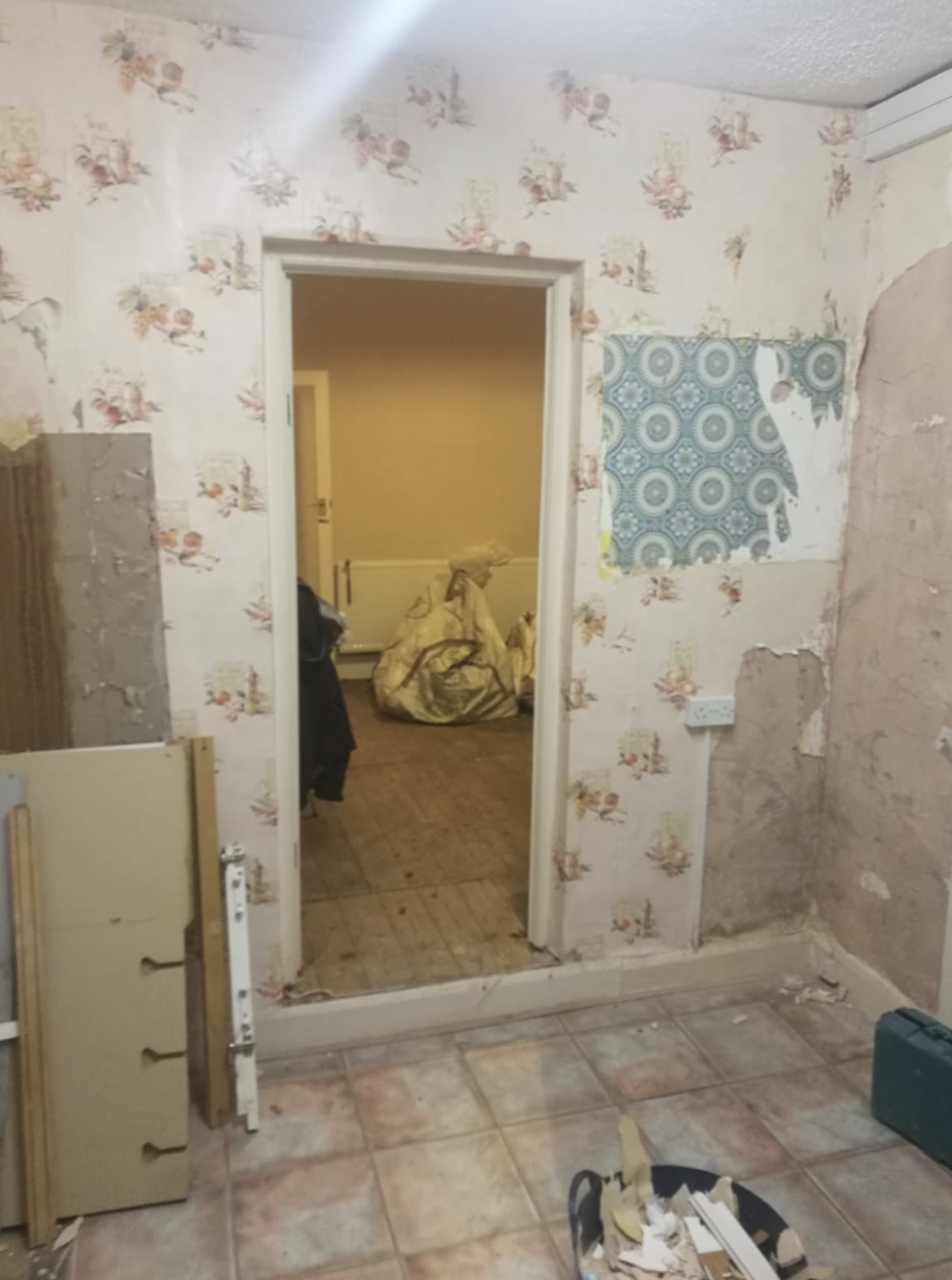

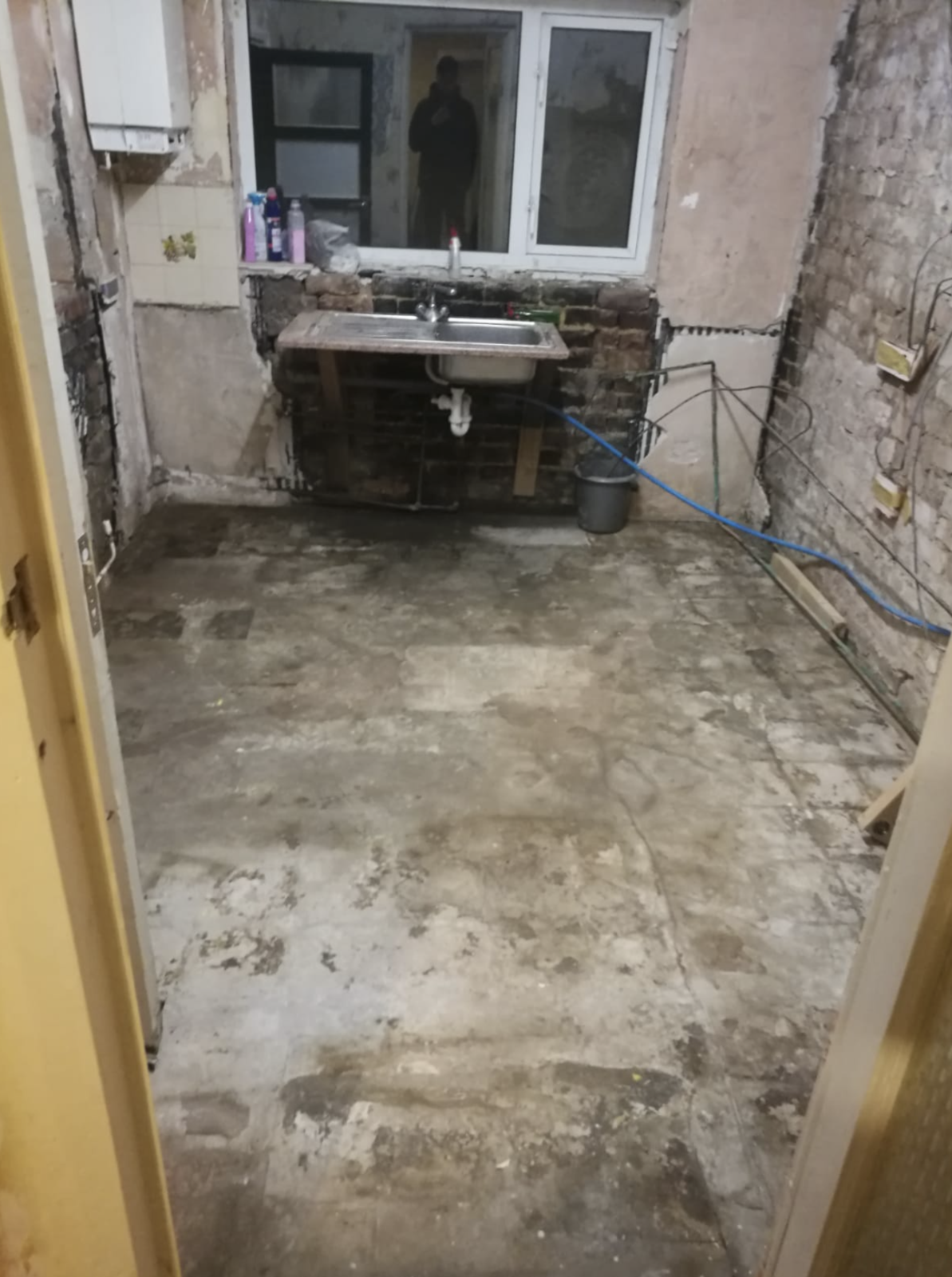

hi all
i have a concrete slab in the rear kitchen which doesnt appear to have any DPM (probably well before they existed) There was evidence of a bitumin lining to the lower 800mm of the exterior wall, but that was in pretty bad shape too and clearly not doing much.
The floor is circa 100-150mm below the adjoining room. I'd like to have LVT flooring in both rooms. Im wondering how best to proceed with putting in the new floor on the basis it hasnt got a DPC. The slab seems pretty dry but im assuming i should lay a new floor direcly onto it and would be better off insulating and lining it in some way?
(Few pics attached before floor was completely out...)
would the best process be to lay insulation directly onto slab, and then run a DPC over the insulation and around the perimeter of the walls up to a certain height to tank the room? This will obviously raise my internal FFL so would there be any issues in raising it deliberately to tie into the height of the dinning room? im cautious that the slab level is basically the same as the outside level which i know is bad news.
Is there a standard detail to rectify a slab without a membrane that i could consult?
Thoughts welcome
heres a quick sketch of what i was proposing. just FYI, the diagonal lines represent the ground under the slab, i presume there is no insulation under there. so
- lay 50mm insulation on the slab
- build a floating subfloor and then
- lay the LVT on the subfloor.
does this seem feasible? how high would you terminate the DPC if i cant tie it into the wall ?
